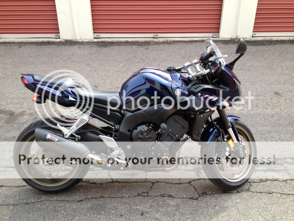

Well I started my cold day with finally taking pictures of the MIVV Suono I put on last week.. (oh! and the T Rex sliders of course ;) )
Before..
After..
Now im just waiting on my copperdawg race screen to come in, and still waiting on my HID Angel Eyes!
woo woo woo... and starting to ponder the FZ1 N headlight conversion.. hmm..
