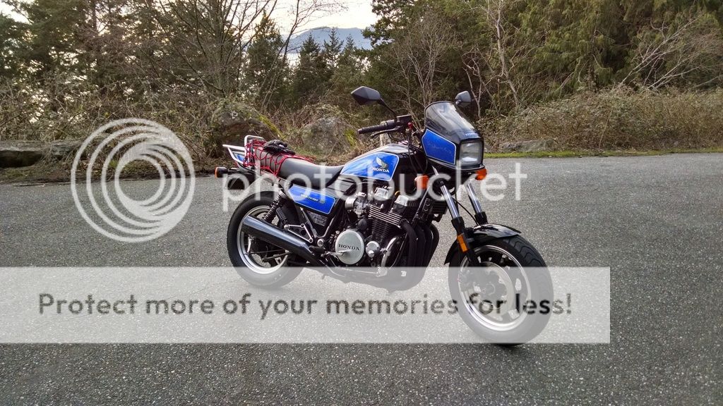

Not a lot, just my typical commutes. I think I've done MAYBE 600 miles this month so far.
I did do a short ride up north a couple weeks ago but mostly we've just been getting grey clouds & lots of rain. Tomorrow I may take a buzz up to Squamish while we've got a sunny break.
