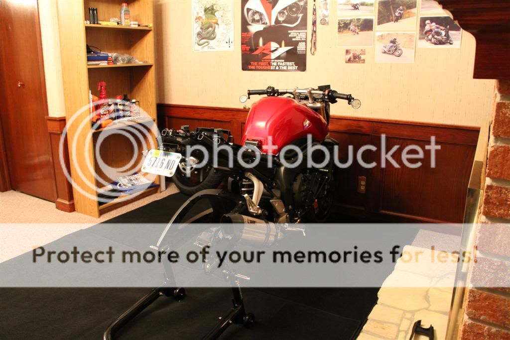

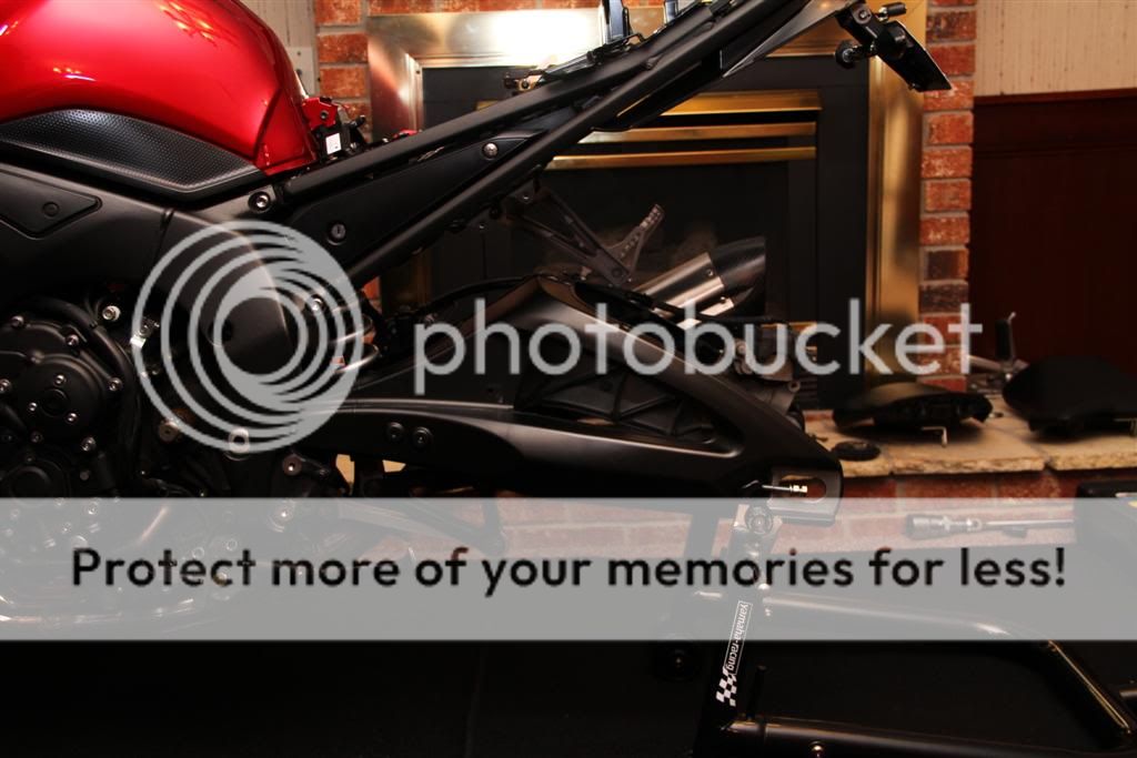

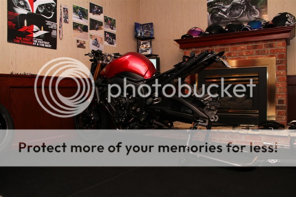

Not today but over the last month I did this:
JB-welded my broken tail handle and front fender and primered, painted, clear coated them with Toyota Black which matches nicely. Not bad for a 1st timer on the weld. Only blooper was that I applied a little too much superglue to hold them in place before jb-weld. As far as primer goes, don't apply it to just the part you want, instead spray it on the full surface otherwise you end up trying to make everything smooth by sanding. I guess I would have saved a lot of paint too. went throught 3 rattle cans.
Also installed the powdercoated passenger pegs with rubber mounted pegs. Painted, clear coated the Yamalude highway pegs I got recently which turned out to be super based on what I learned from my mistakes with the prev paint job.
Getting ready for parts to be put on and doing some deep cleaning!! :wilynily:
