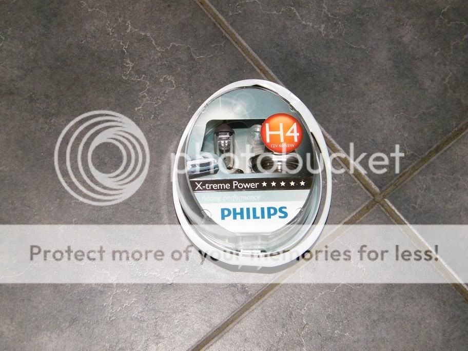

Bought myself ...euh my bike a set of Philips H4 Extreme Power front lightbulbs. It's said to have 80% more light...installed just one eye to catch the difference first...
