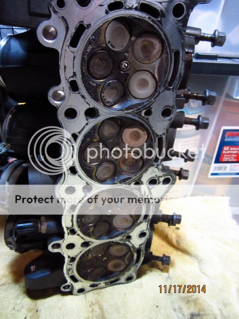

So we got the engine out and the valve head off. Here is a photo of what the pistons currently look like underneath. Remember, this is a 2006 and it has 90,000 miles on it. Is this normal wear and tear for this age and mileage?

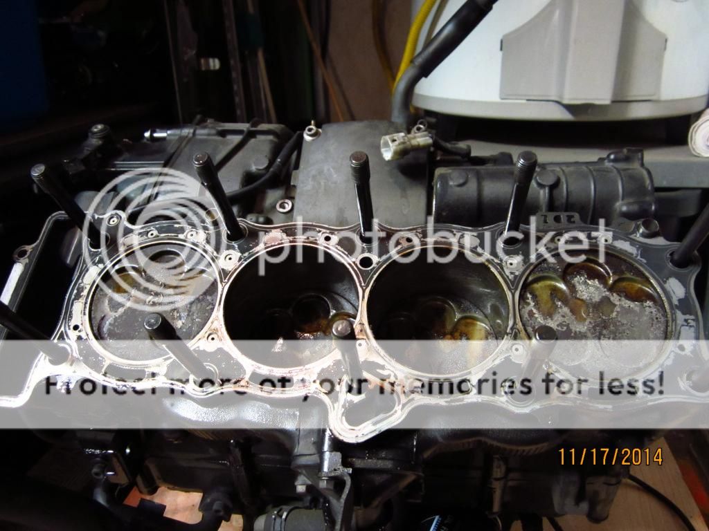

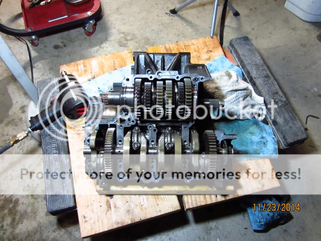

So we kept finding copper windings from the exploded stator so we kept tearing into the engine chasing all of the copper pieces we could get our dirty hands on. We ended up here yesterday.
How are you getting the copper out since you can really use magnets? What a nightmare.
