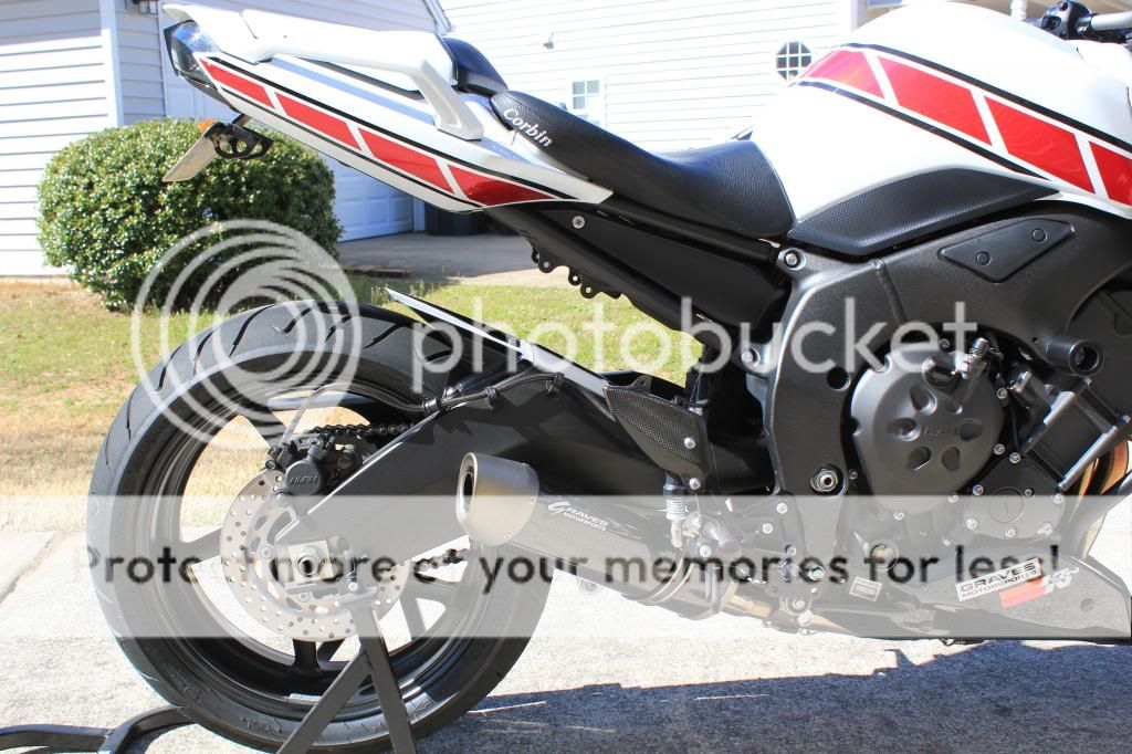

This is part of the reason I went with Graves. Also because Yosh is more of a Suzuki bike brand than Yamaha in my eyes anyway. I wanted something that fit and finish was a little better on goes with the lines of the bike more and don't need a bracket off the passenger area to support it. Yosh has a good set-up I just wanted something different.
DITTO !! And the welds are artwork.
