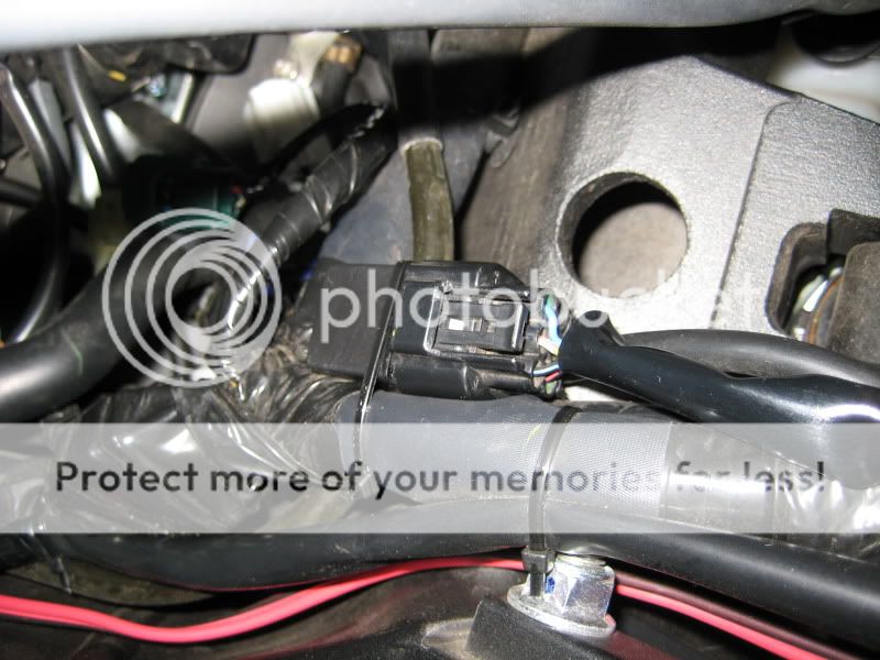

Graves EXUP Servo Eliminator
Well I came across a great deal on a Graves EXUP eliminator in the local craigslist :). It was from an '05 R1, but fits the FZ1 just the same and for $25 I couldn't say no. Here are some pics of what it looks like and then installed:

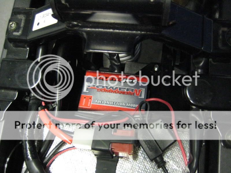

My PC V is lonely in there now that the EXUP servo is gone. Wow look at all that room :D

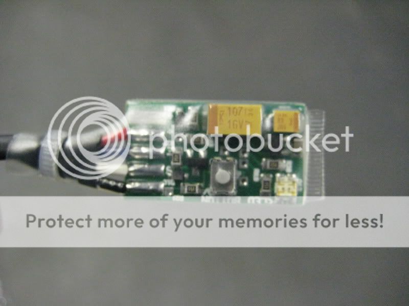

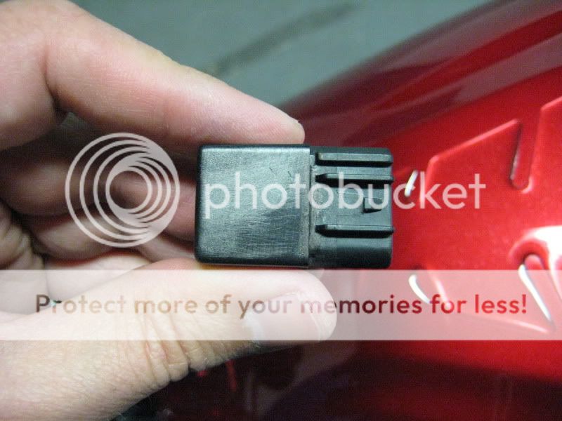

SpeedoDRD Installed

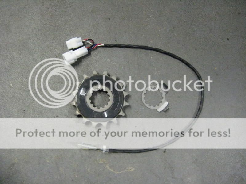

Also got around to installing the SpeedoDRD in preparation for the upcoming installation of the 16T front sprocket. I did not calibrate it yet as I'll do that after the sprocket change, but from what I have seen from others the correction factor should be around a 10.7-10.8%. I'll try and use a GPS if possible to get a really accurate calibration percentage.
SpeedoDRD, 16T Sprocket and lock washer:
SpeedoDRD close up:

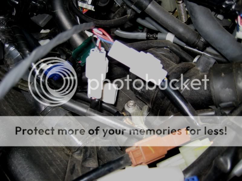

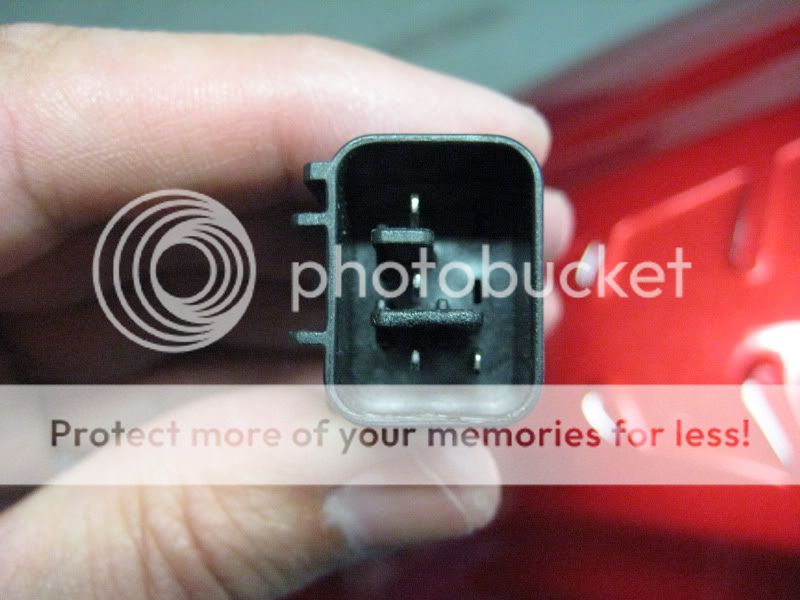

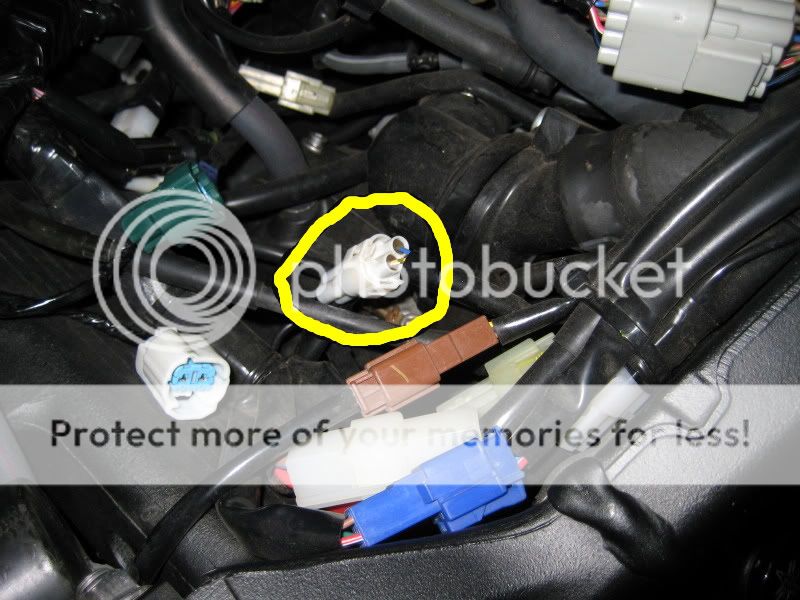

Speed sensor connector (circled in yellow):
Disconnect speed sensor and connect SpeedoDRD harness to either end:

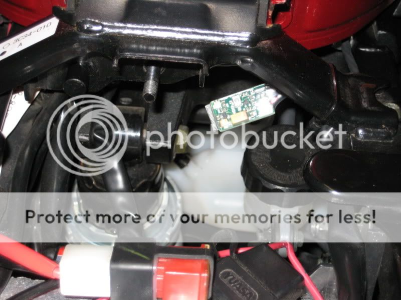

I ran the SpeedoDRD harness along the frame under the gas tank and zip tied it in place. Whenever I need to calibrate it, which will only be once provided I don't switch sprocket sizes again, all I have to do is remove the front seat and it's right there:
