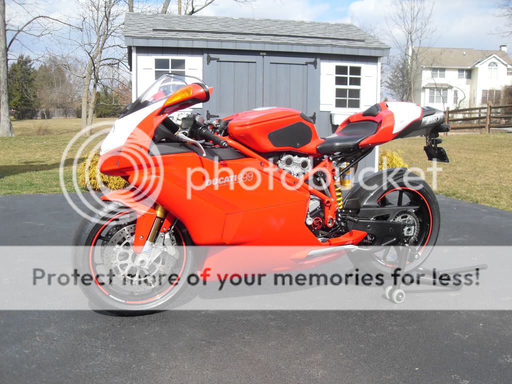

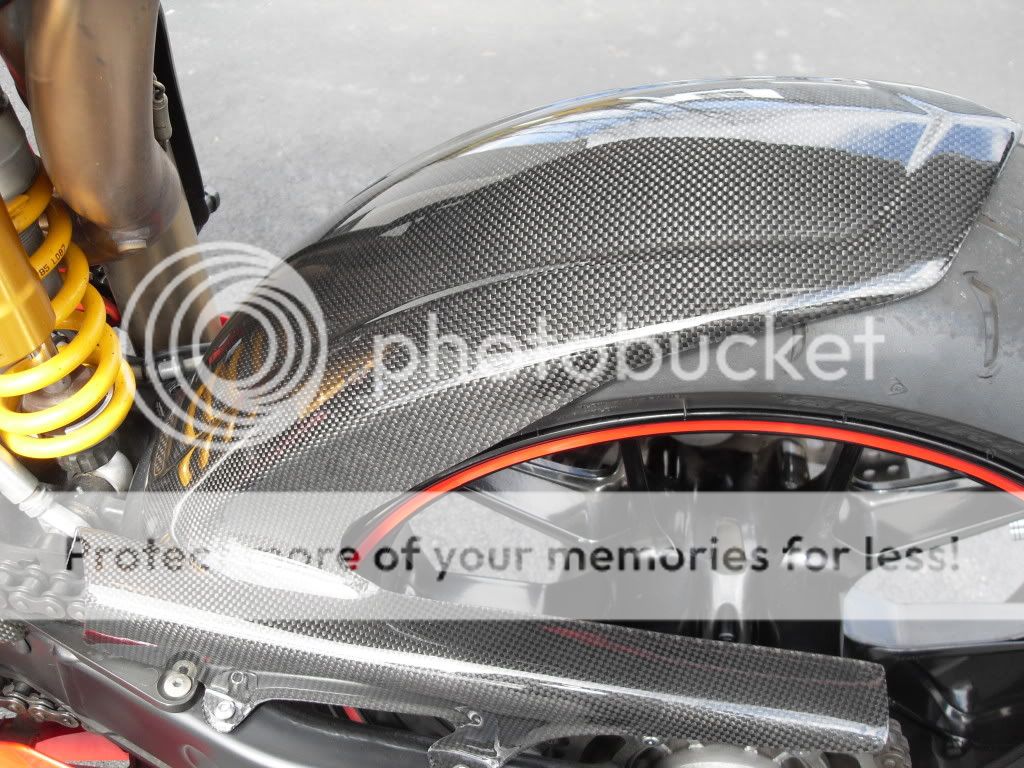

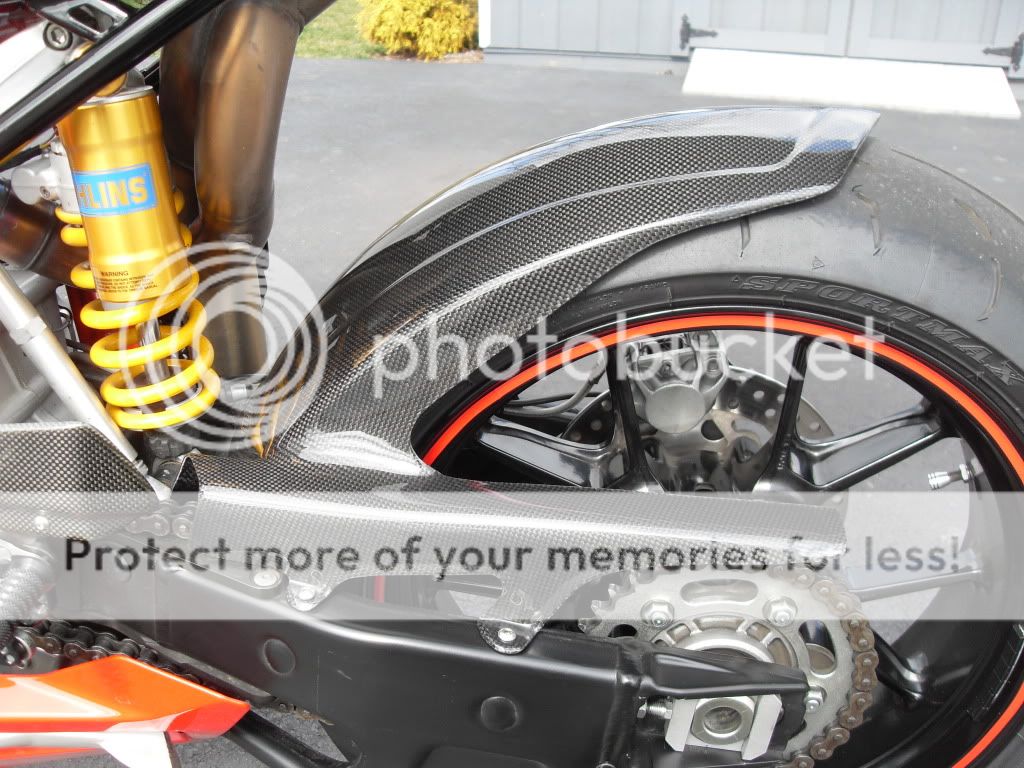

Bill, here are a couple pics of the tire hugger I put on my 999 last weekend.
Here is one of the bike in the driveway today while the sun was out.
Thanks again for showing me how to use the photobucket acccount settings!
Holy Crap, thats a sick bike!!! I'd love to take a spin on that one day! The hugger looks great. What company makes that one? The best thing I love about my hugger is that it comes with thick, heavy rubber grommets that go into the mounting holes, and then it has a steel bushing that goes into the grommets. When you screw it down tight, there is absolutely no pressure applied to the hugger itself, and anyone who has had aftermarket huggers knows that the mounting holes are the first place you get cracks due to vibration. Awesome job Pete. Thanks for gracing my thread with your Duc!!!
