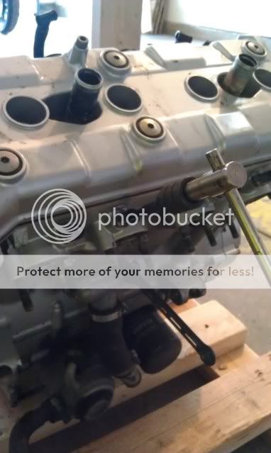

Ive pulled all the plugs, they are in excellent shape. I turned it over by hand and everything feel very good. The engine is in much better cosmetic shape than what I have already, so hopfully its just as beautiful mechanicly

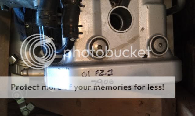

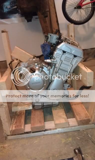

688 shipped to my door. 488 for the engine and 200 for shipping.
That's about what I paid for mine but yours has less mileage and doesn't have any road rash. I had to move some of my crankcase covers over from my old motor. The good news for me though is the new donor engine purrs like a kitten.

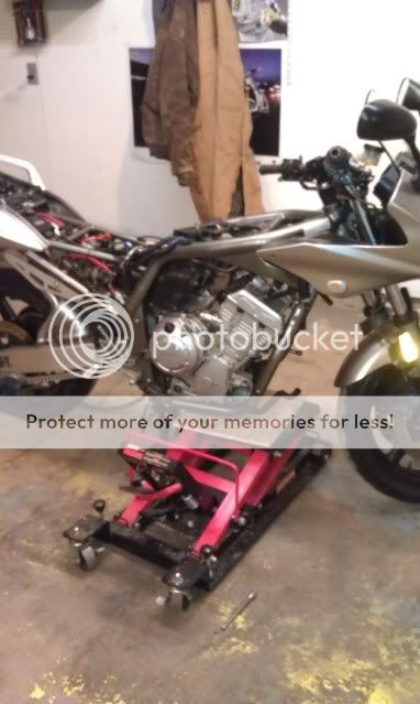

After a delicious breakfast,and much needed coffee we decided it was time to get moving.

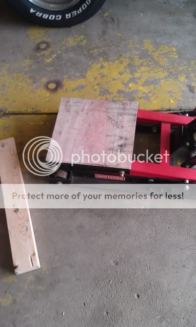

removed from crate, and set on jack. The craftsman atv/motorcycle jack proves to be a blessing!

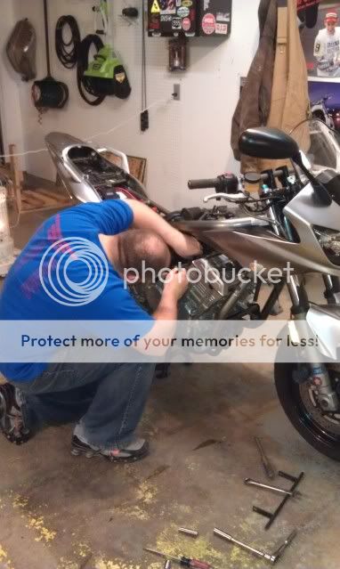

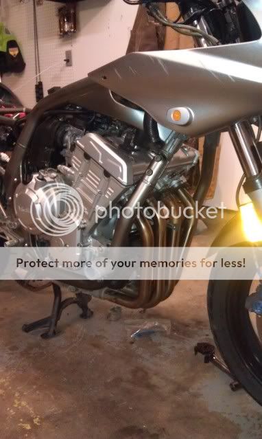

engine now installed. My brother from another mother, looks things over.

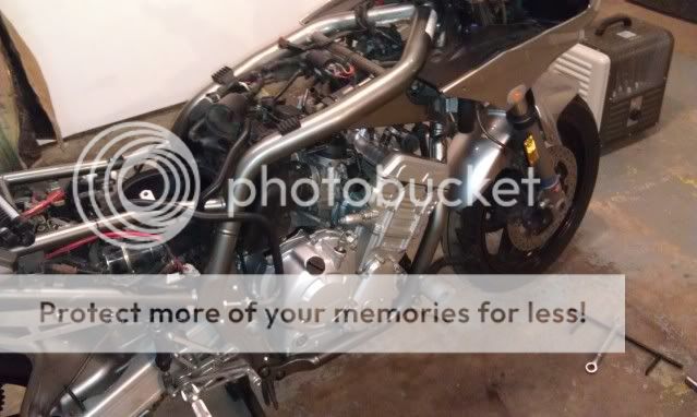

Header installed
radiator installed

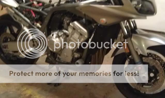

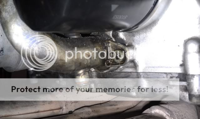

The bike runs fantastic. Shifts 100% better than the old engine. It appears I may have a slight coolant seep. It seems to be seeping just ever so slightly right around the housing that you drain the coolant from. I checked the coolant drain plug, its tight. Theres also an allen head bolt that goes into the block that holds the hard coolant line . Its tight. It seems to be seeping around that general area. Does anyone have any insight?
Great job on the engine transplant. It's very satisfying when you're able to do something like that yourself.
Not a Gen I guy so can't offer much advice as to the coolant leak. Obvious things would be a bad o-ring or gasket. Are all hose clamps (if any) in the area tight. Doesn't hurt to go back and double check everything. Sometimes it's easy to overlook something simple when dealing with a complex and challenging job as this one.
