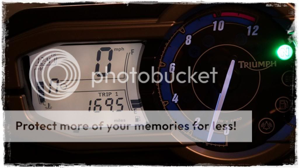

Trip was reset before I left sellers home. One cool thing about the Triumph instrument panel is that it includes, as standard, a gear indicator. I have to admit it is handy especially when getting to know a new bike.

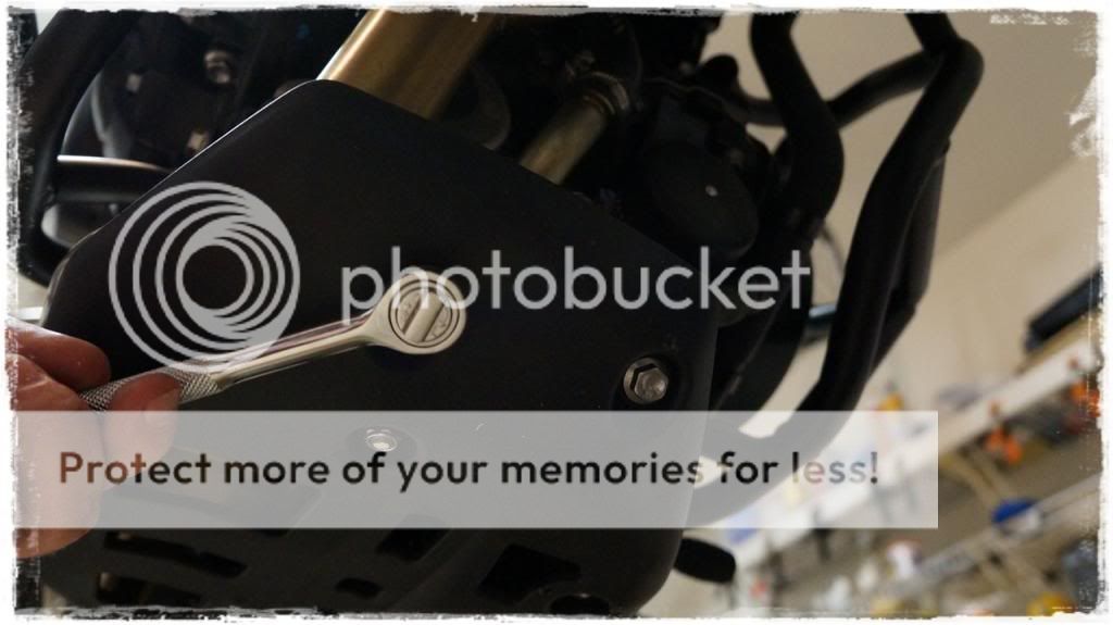

First thing I wanted to do when I got home is remove the stock skid plate and install the AltRider Skid plate.
For those of you who did not believe I wrench. Here is an action shot. I can't lie to you guys... I just posed for the photo and my wife did the work.
New Skid Plate Installed
