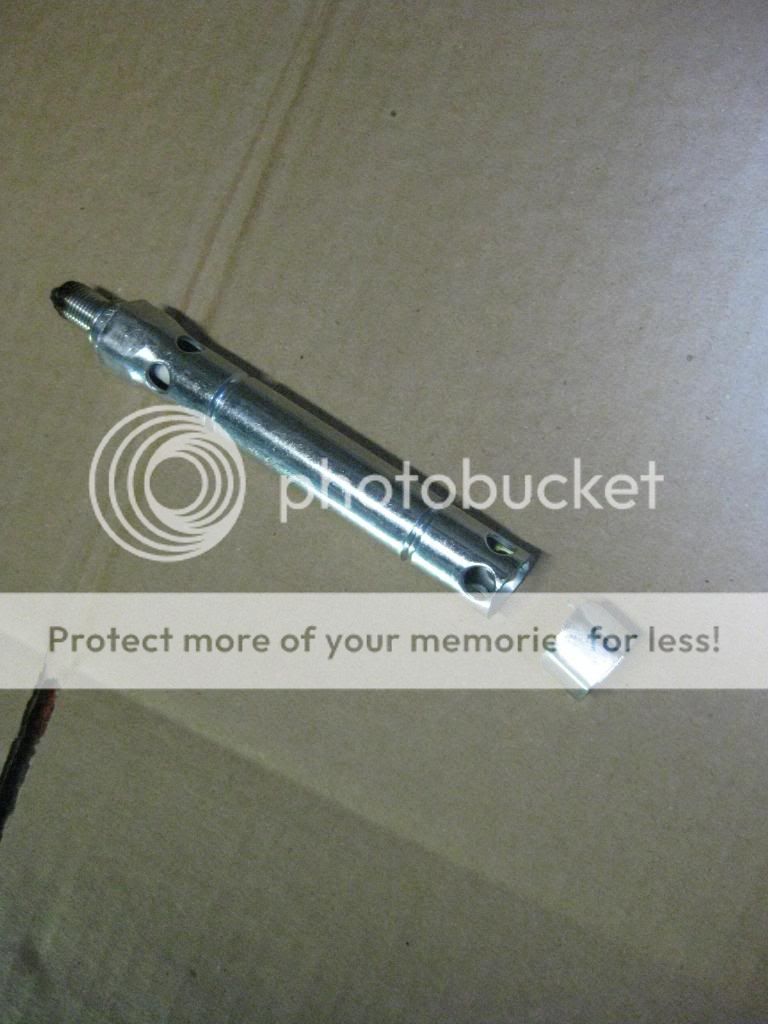

After I calmed down I decide to try out my new spark plug tool that I got from Great Britain. I attempted to get to the plugs from the bottom so I tried the number 1 cylinder. Being that the tool has two sizes, one per end, it was too long to make the bend onto the plug. I broke out the cutting wheel to make modifications. I cut the end which I won't be using and then it went in perfectly.

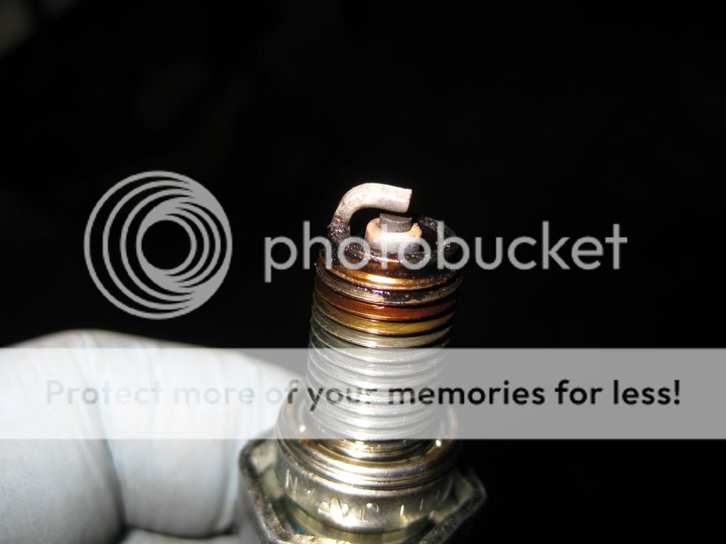

In seconds the first of four was out! Aside from the grime I got on it, it looks like it's burning just fine.

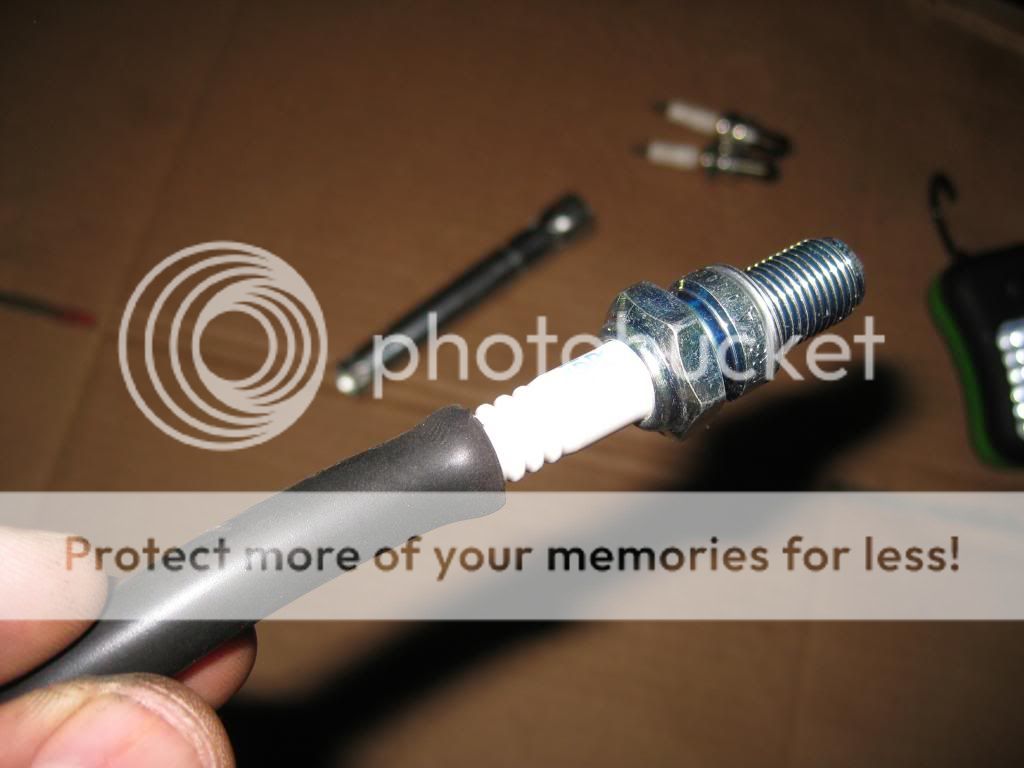

The second cylinder would be a bit tougher. So again I had to improvise. I cut some rubber vacuum line, then broke the plug loose with the wrench, removed it and inserted the hose. It was out like nothing! This is gonna be a breeze!
This is how it looked with the hose attached.

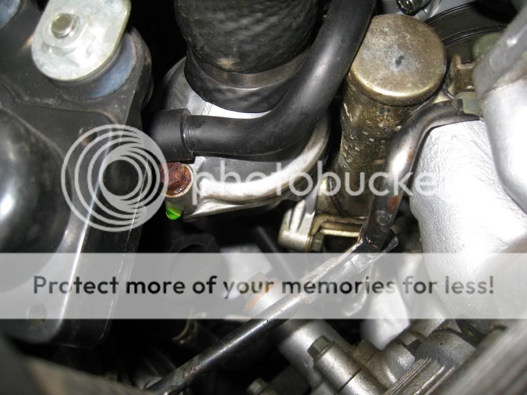

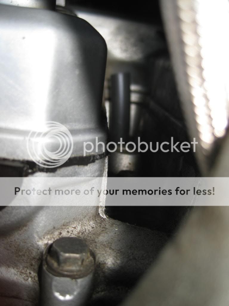

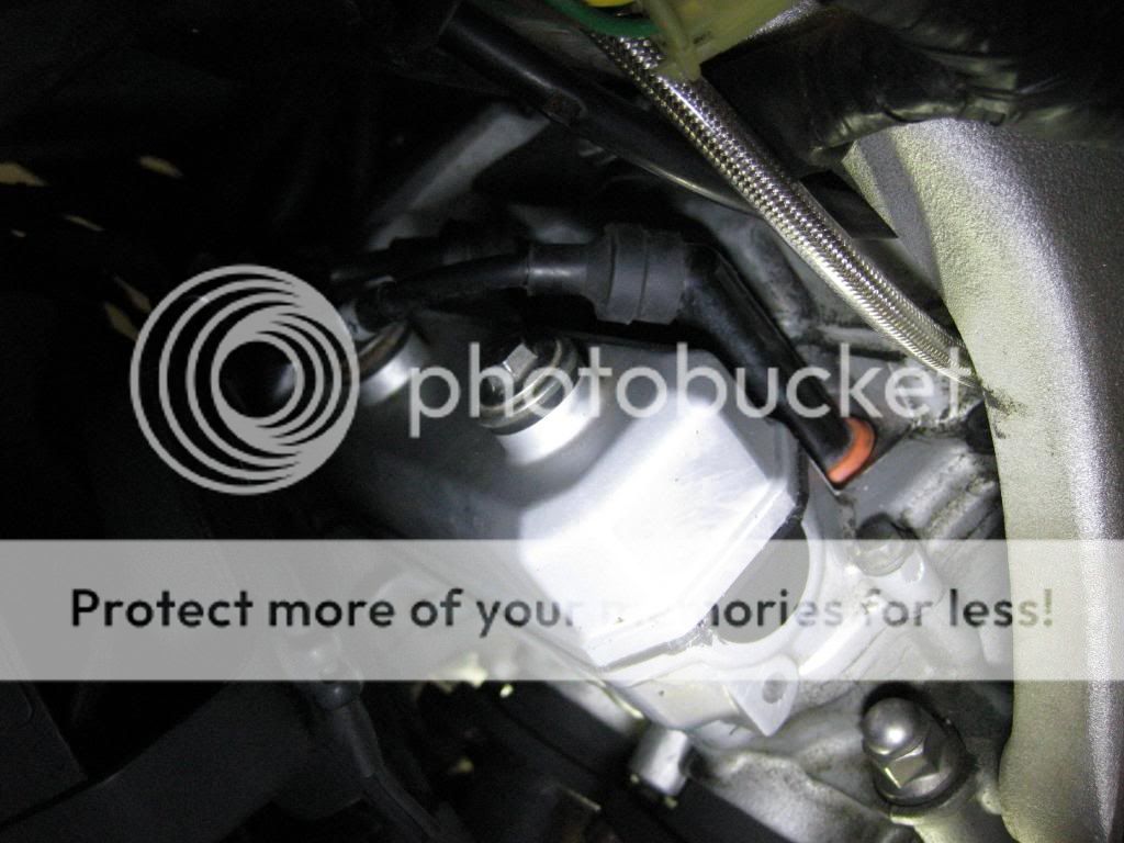

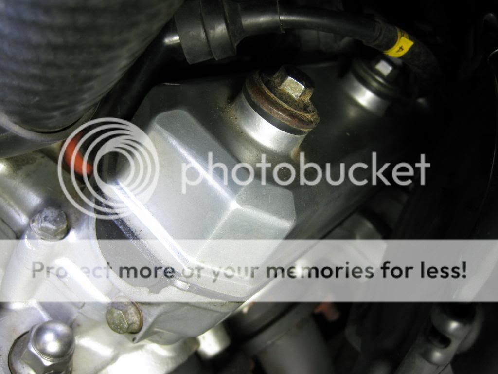

While I was laying down I was fortunate enough to have found the coolant leak I had seen. It looks like the thermostat housing. I'll have to change that gasket, or maybe a hose. I'll have to lift the tank to see.

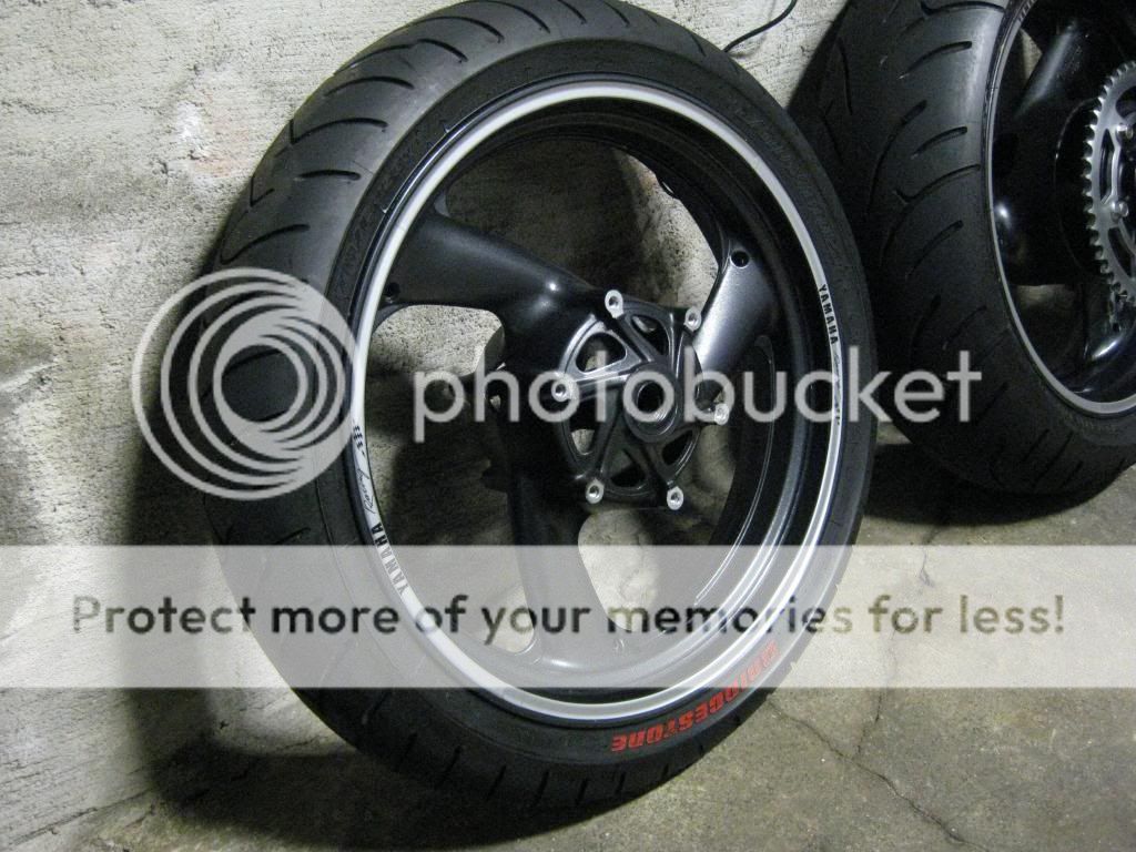

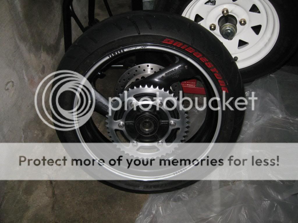

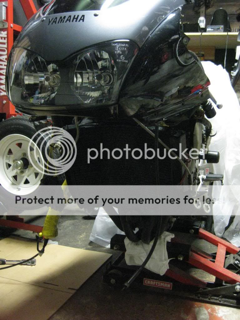

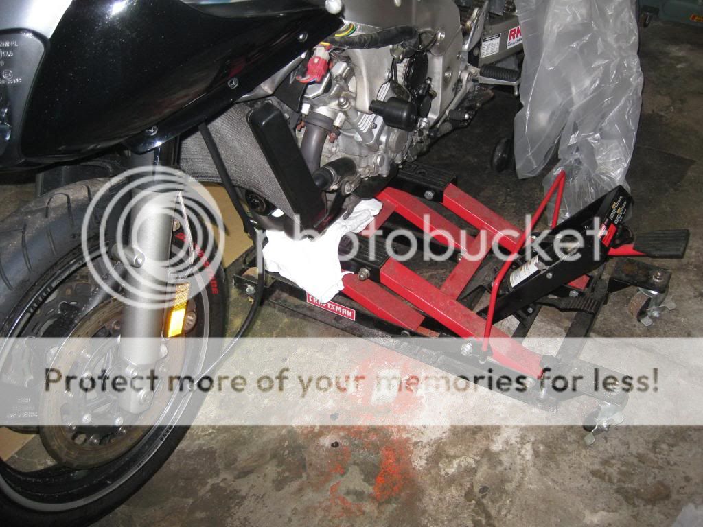

I decided to start on the front end next, so I broke out the lift I got from Earlzach (David), and gently hoisted her up just enough to get the wheel off the floor, then locked it in place.

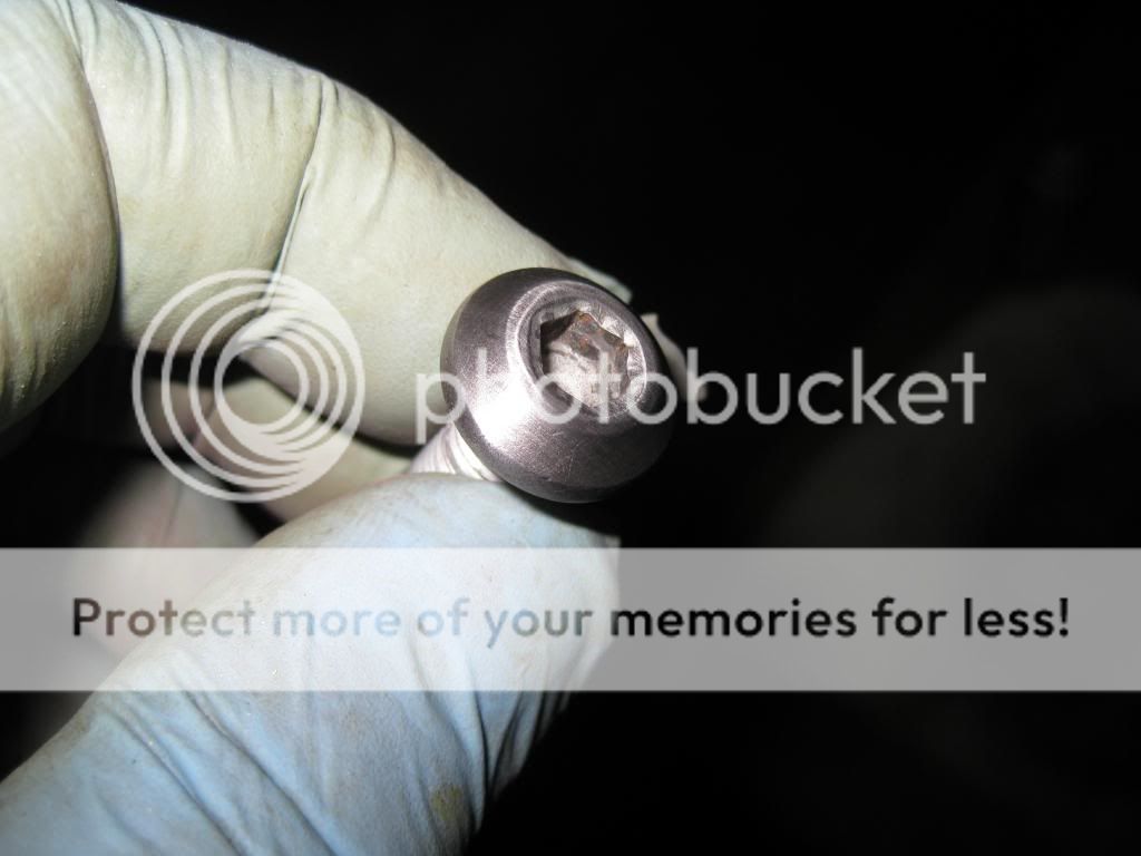

I got the filthy front wheel off, and also noticed that my "pinch bolt" is missing from the fork. I'll have to see if I have it laying around, or if I never had one on there.

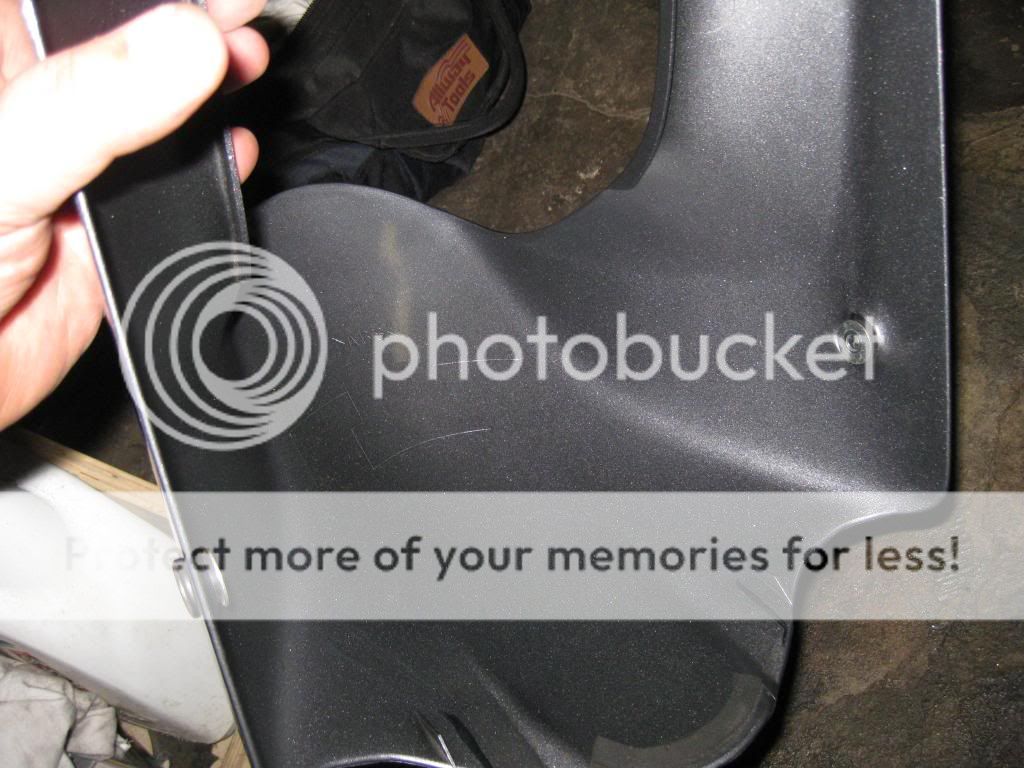

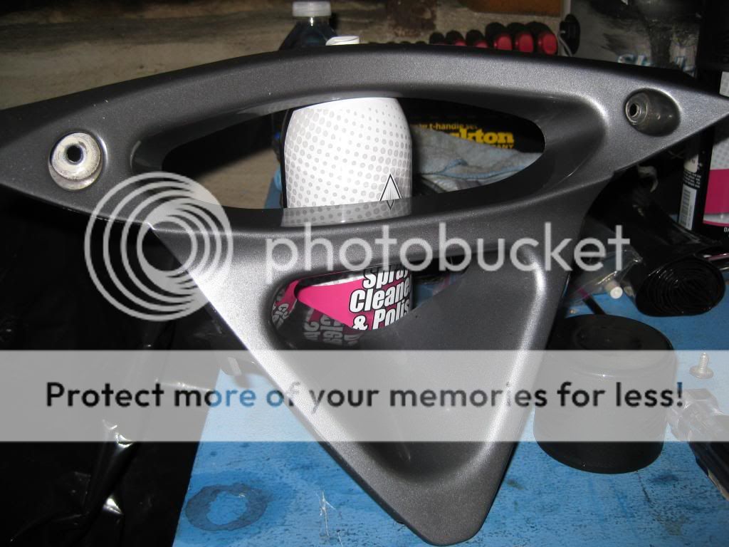

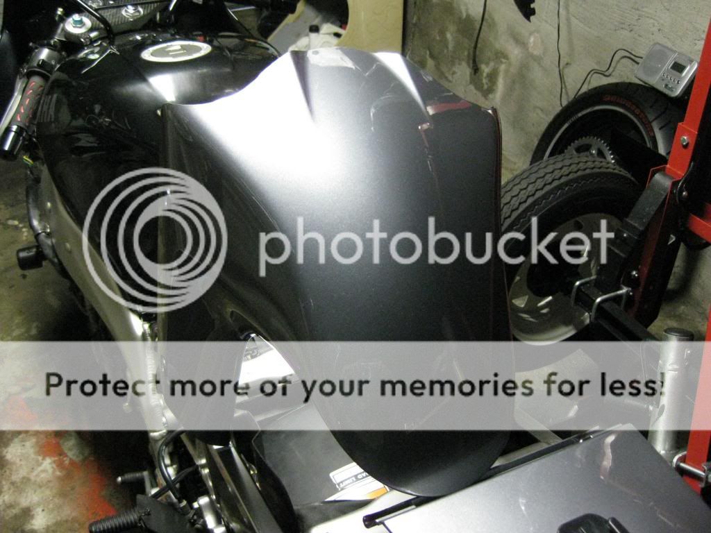

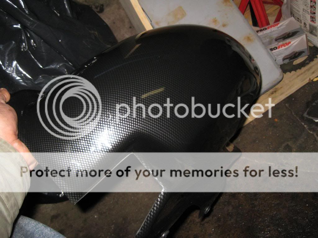

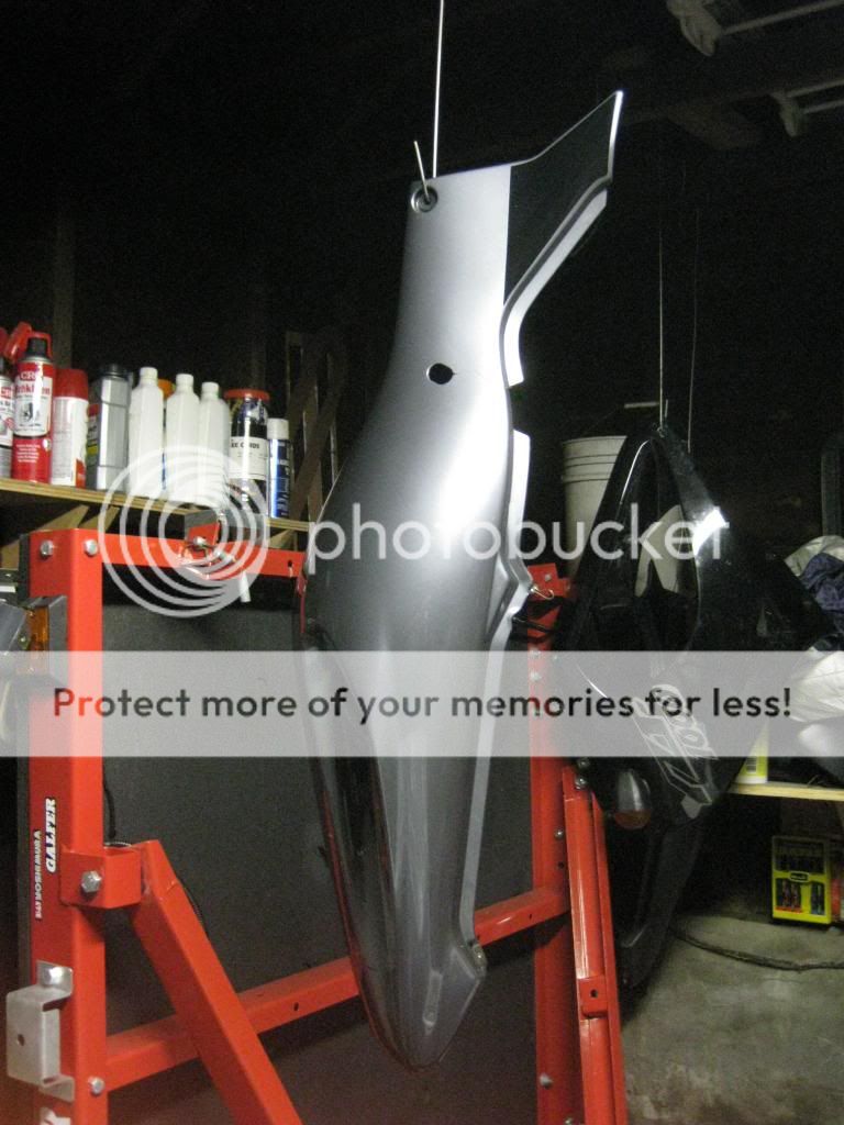

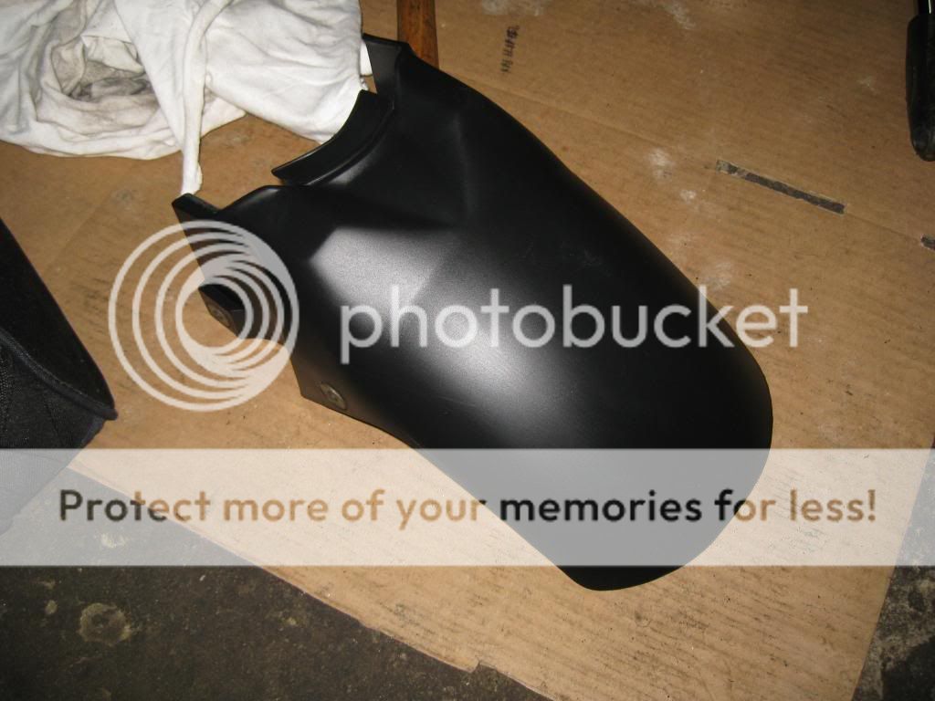

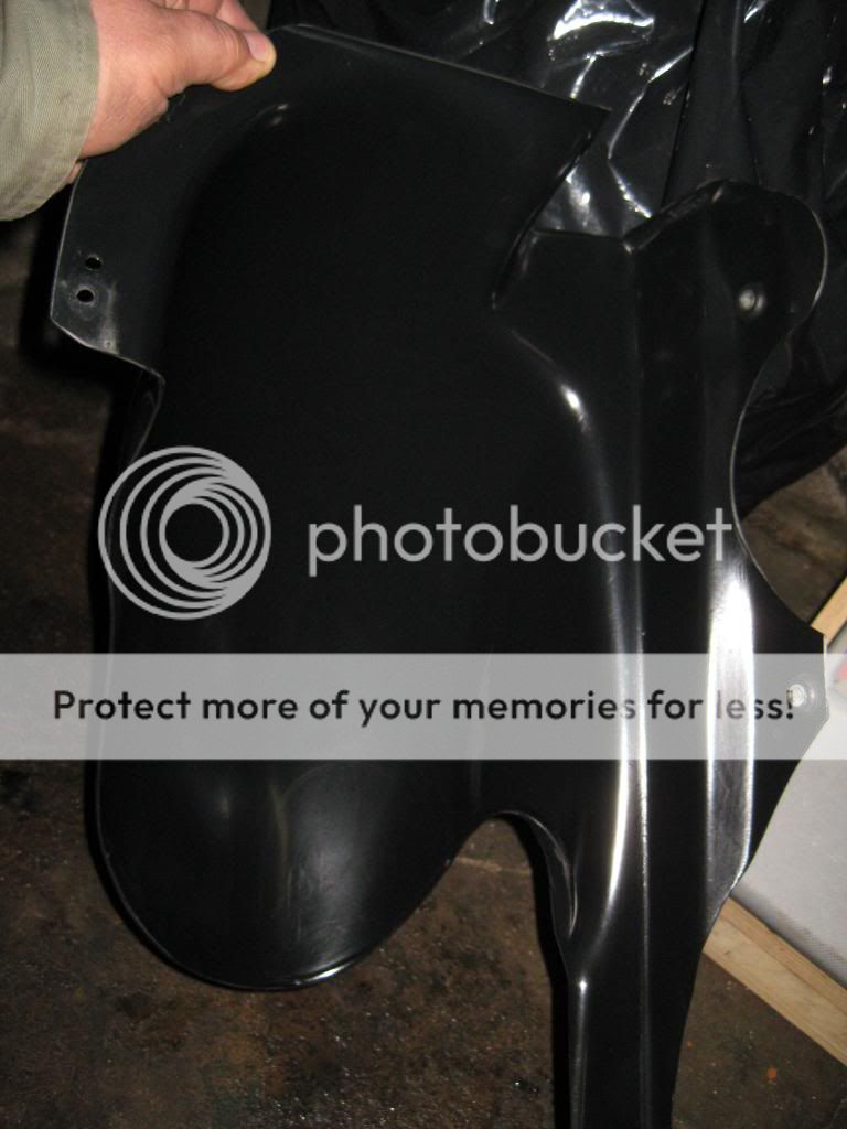

I cleaned and polished the rear front fender so that was done.

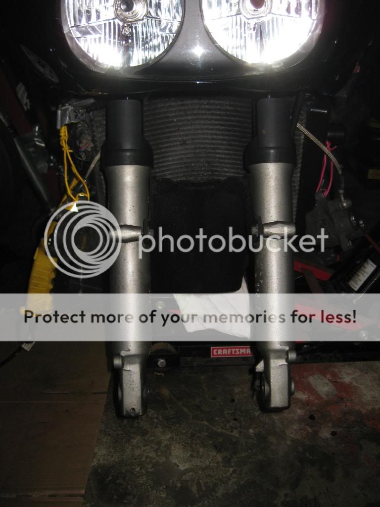

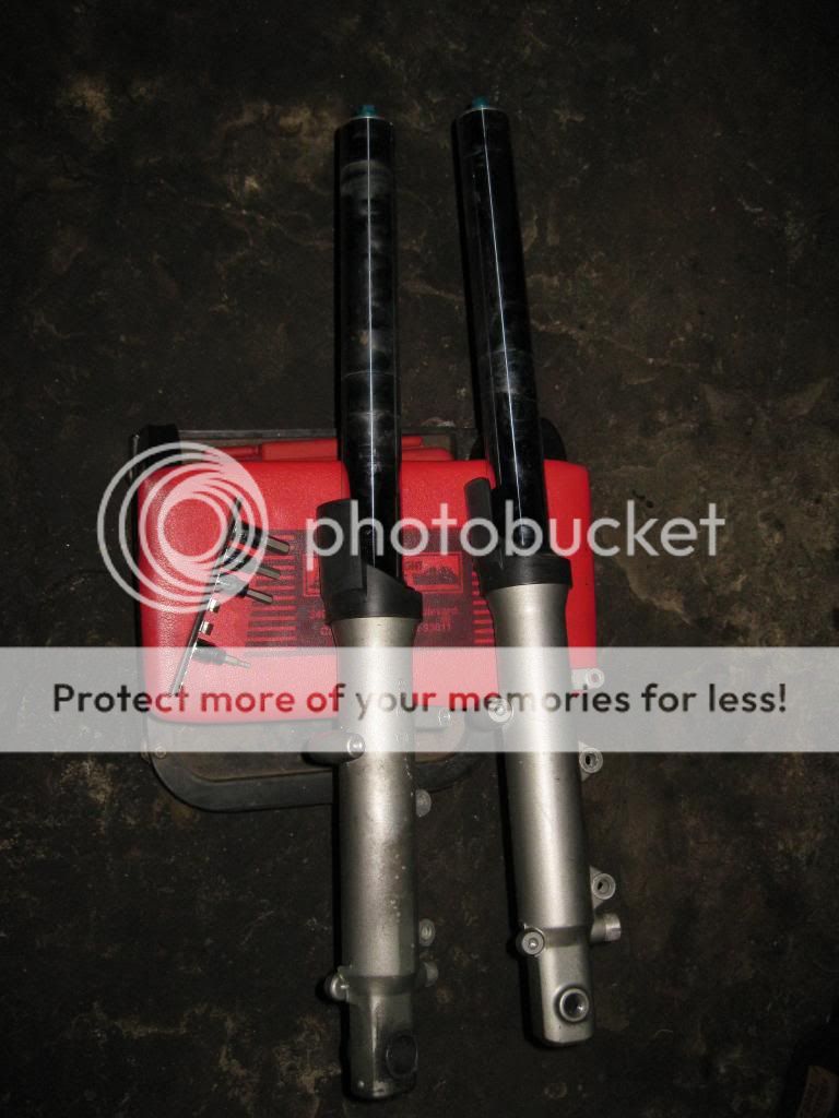

Next to go were the front forks.

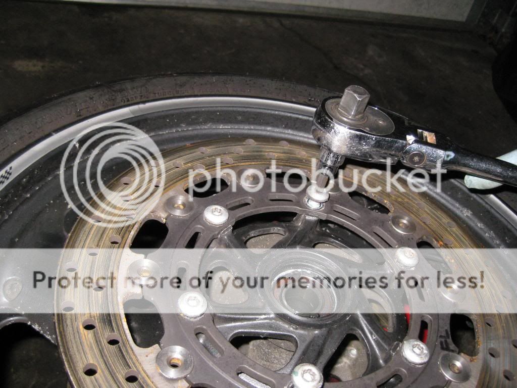

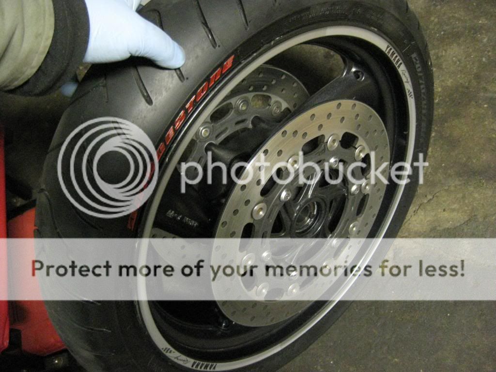

I then broke out the heat gun and hit each rotor bolt with some heat to melt the locktite which made them come off easily.

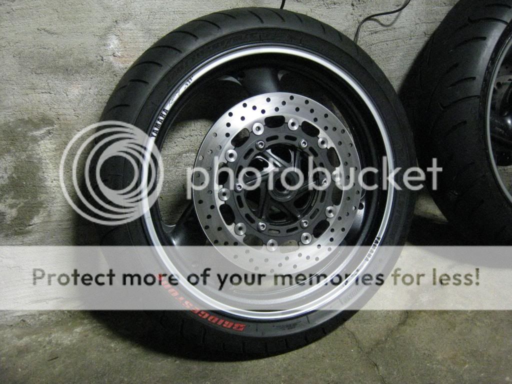

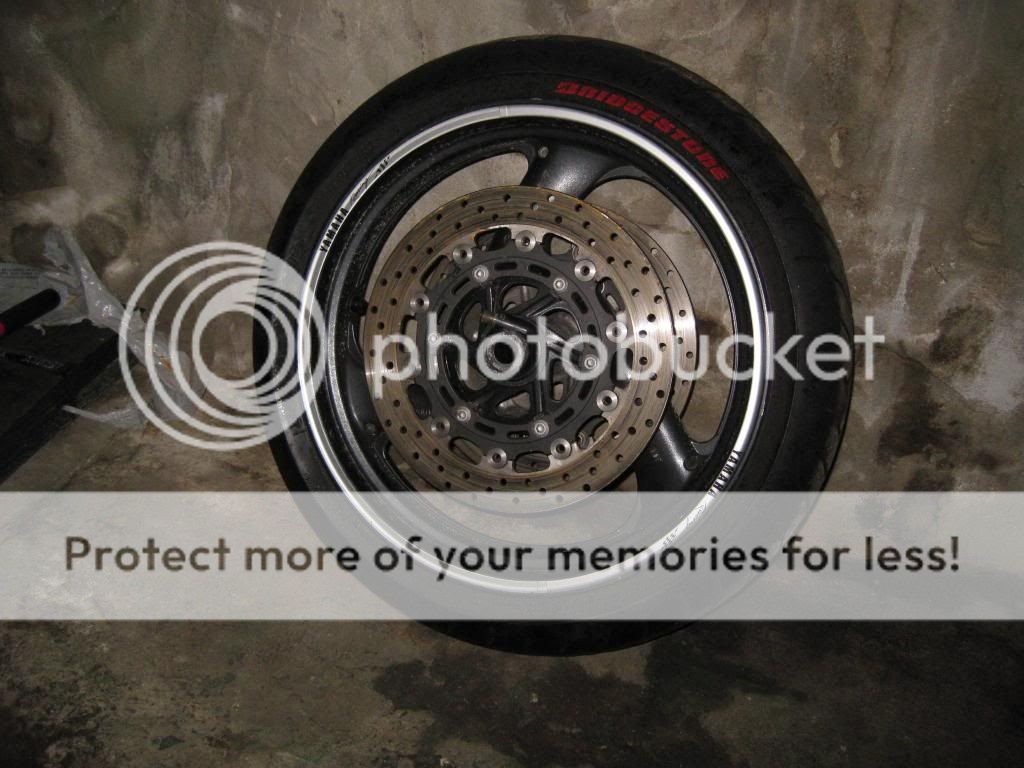

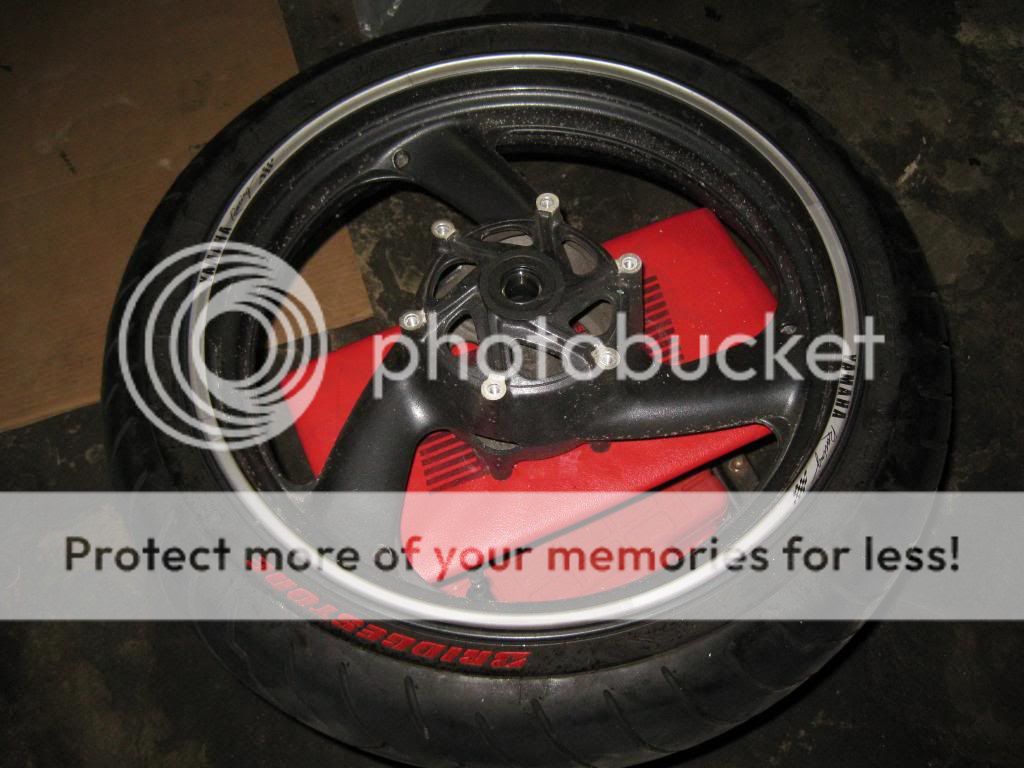

Dirty Wheel!!
I hit the wheel with kerosene to remove all the crud, and then polished it up good with the Honda Polish. Wheel Clean!

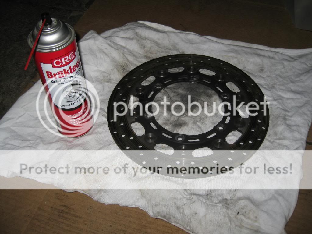

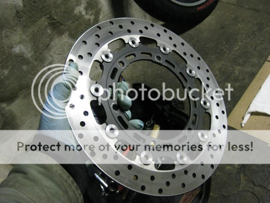

Next I took the rotors and hit them with fine scotch brite and brake cleaner.
The rotor came out beautiful.
