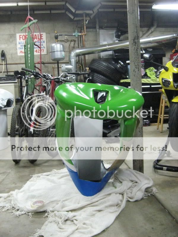

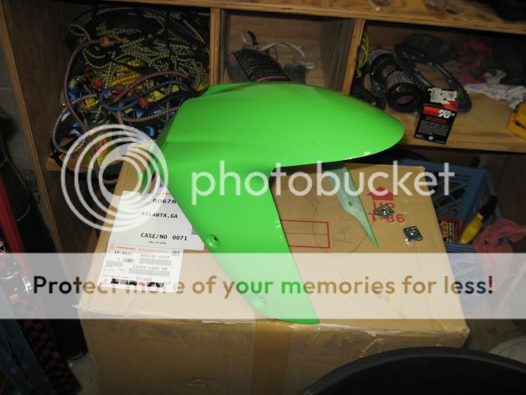

My impatience got the better of me to day. I did a lot of wet sanding and had every thing looking great. I decided to clear coat the fender and the rear cowl. I have to leave the garage door open because we have a apartment above it and I don't want to fume out our tenant. I'm guessing it was to cold after about 1 minute it wrinkled up like a old mans skin. Back to sanding again. I guess I'm on hold for temps above 50
Well it will be almost 60 degrees around here on Monday so it should be pretty much the same by you. Time to spray that clear coat again...

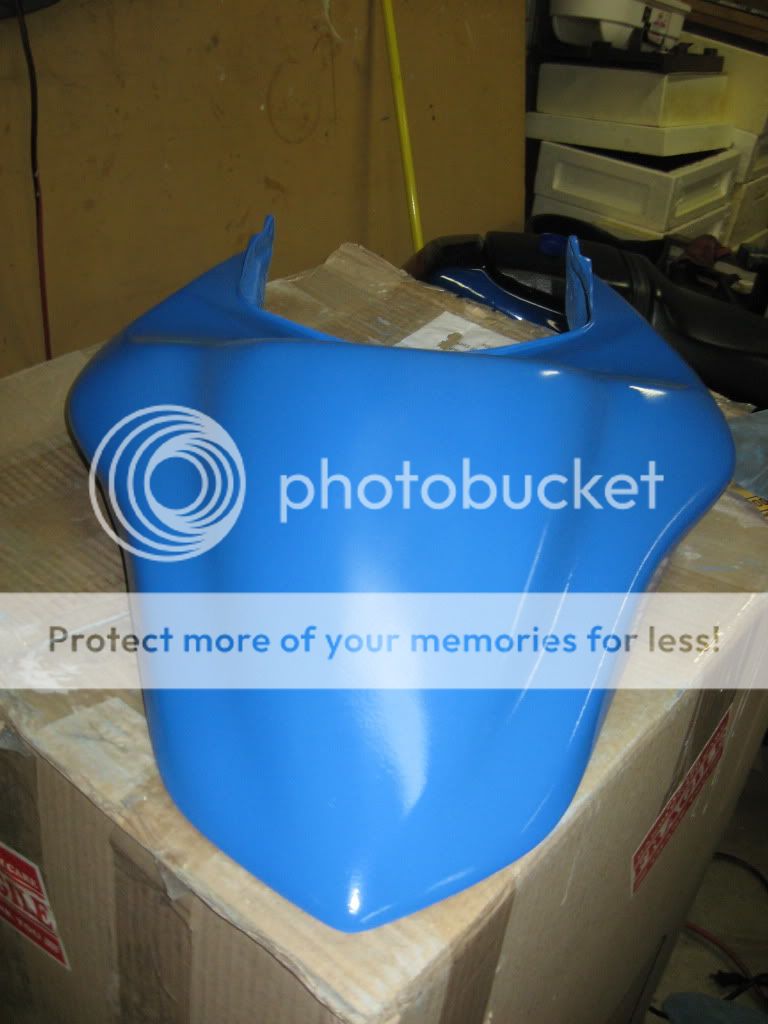

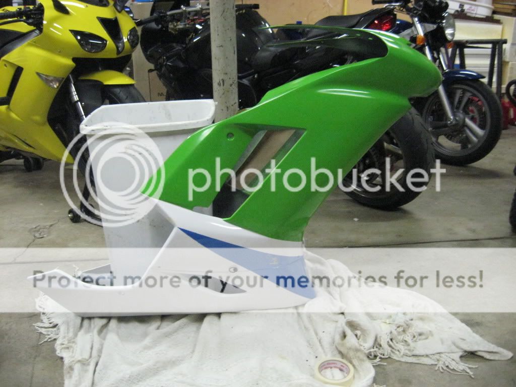

Well I took the fender and the cowl down repainted and cleared. I stripped the black tank I bought primed and laid the white down on it. It still needs some time to harden up before sanding. I could have had the fairing complete but once again lack of patience got the better of my and need to do some sanding and repairing tomorrow. I looks good, definitely not professional but I'm okay with it.

I'm getting close. I had to rewire a room in the house and have been splitting my time between the two this week. I need to put the blue on the tank, clear the upper, clear the tank when its done and paint two small plastic pieces. I'm hoping to be done and mounted by Sunday. Today I installed my Galfer front lines. I ordered EBC HH pads all around I got 1 set of fronts and the rears today. I still waiting for the rear line and 1 set of front pads. I want to set in the pads before the bike is not legal any more so I hoping that stuff come in ASAP.
