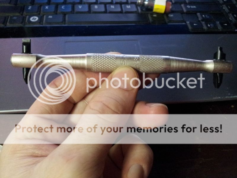

Here is my most useful tool:
:p:laugh2:

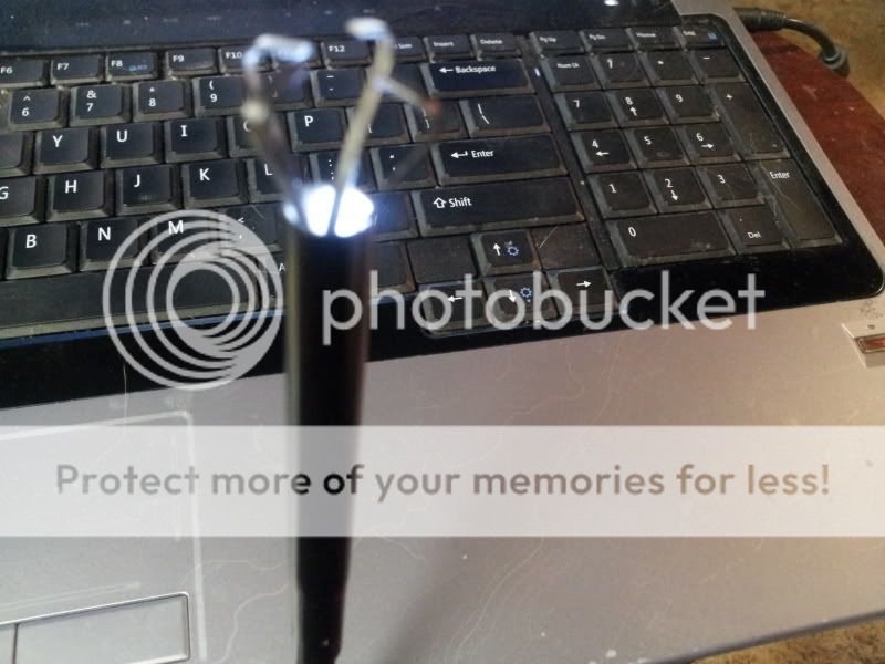

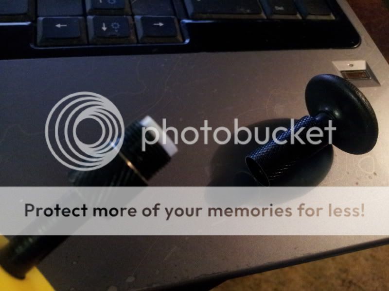

A quick follow up

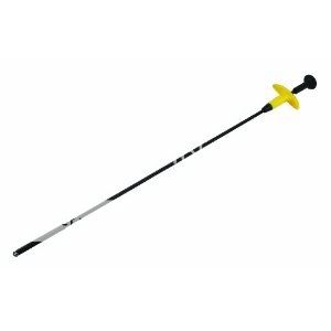

I have several of these but I only have one with the LED light. That makes a HUGE difference!!! In fact, when I went to grab it a few days ago - I was really disappointed to find that the light had gone out. As soon as I finished the job I ordered another "Grabber" without even thinking twice.

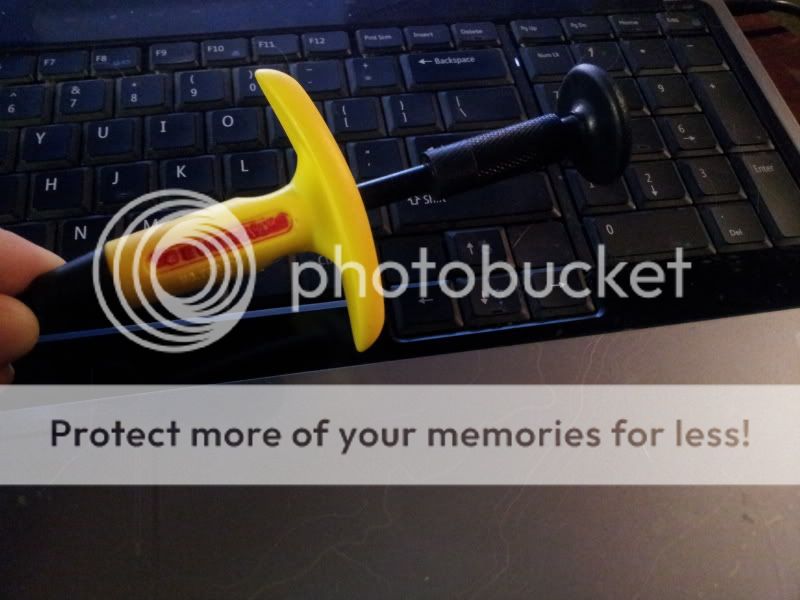

Just sitting around killing time I decided to look at it. I figured there has to be a power source somewhere:
Turns out it's in the handle

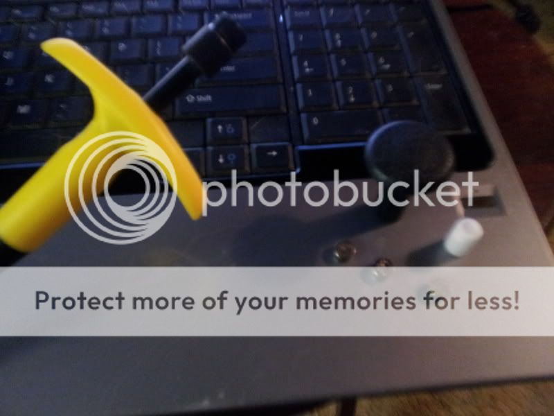

A few quick turns and it reveals a battery pack of three LR-41 batteries.
A search online finds 10 of them on Ebay for 60 cents - Shipped. That saves you $15 for replacing the tool - plus it gives me some satisfaction of fixing something.
Hope this helps someone save some cash if your light goes out :D

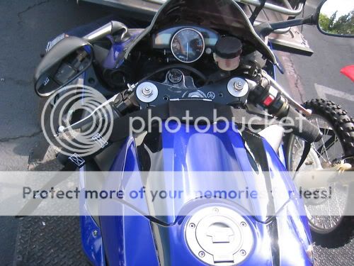

I believe this tie-down is called "canyon Dancer". It is invaluable. I've had mine for many years. Mostly it just hangs on the wall, but when I need it, it is often the only way to strap down a bike.
Yep that's the name, Anyways this one is a few bucks cheaper hopefully the quality is as good. I will review it when have an opportunity to use it.
