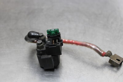

Hi, I have just bought my self a non running fz1 and it wont even crank over and I have no idea where to start really, they said it was the starter solenoid so i bought one and installed it but it still wont turn over, the engine is free i turned it by hand by putting the bike in 6th and turning the wheel, also the neutral light doesn't turn on even if the bike is in neutral, it dash is actin weird, when I turn the signals on the dash turns off for, also when I turn the headlight to high beams the dash shuts off then comes back , any help would be amazing as i'm a absolutes newb to repairing street bikes its a well used bike that has some minor damage but nothing that i can think of that would cause the bike not to turn over, also i checked the battery and it has a reasonable voltage and hot wired the starter and it turns normally, it just wont turn over with the button, any help would be amazing once again many thanks

so update the battery was about .4 volts under the reccomend level and so that solved the issure with the bikes dash flickering, but it still wont crank over, I checked the continunity of both the clucth lever switch and the kick stand switch and they both seem to be responding correclty, the only other thing I could figure out it maybe being was the starting circit cutoff relay but the wiring diagram in the maueal has diffrent wires so im not sure how to check it of it would be a possible cause to the issue, also unreleated any good places to find crashed fz1's for parts?

It's connected to the hot wire on your battery, actually it's part of that wire. . A relay is used to switch power off and on in larger wires. The wire coming out of your ignition wouldn't be big enough to spin a stater and the engine connected to it. The relay is a switch that's activated when you turn the key. The switch acts on larger wire from battery to starter.
