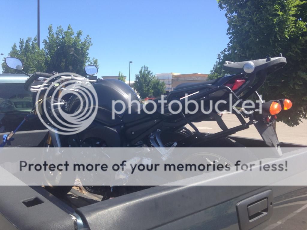

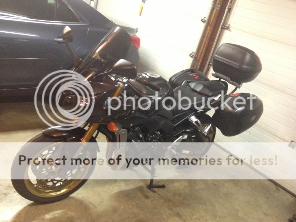

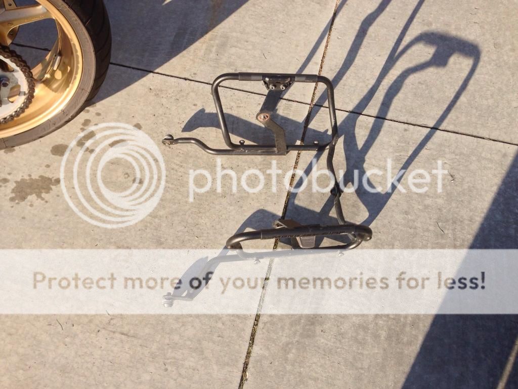

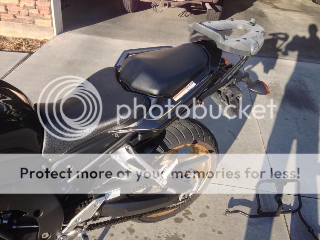

If you need any pics let me know, here is a few I have now, hope it helps.
Brackets for side cases that comes off
Brackets off the bike
Brackets on bike
I would like to add that the outdoor pictures are from the guy I was buying the bike from, that is why the bike looks dirty and nasty. It has been intensively detailed since I took possession (saved it.) The guy rode it but didn't keep it clean :mad:
Hope the pics above help
