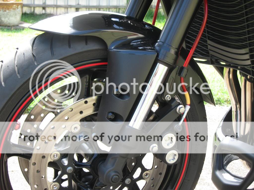

Another spot for your two tone treatment. The lower (fork Protector part) of the front fender is a good spot for plasti dip. It's prone to chipping from road gravel and might look good too. How did you get a sharp edge to your plasti dip? When I did my front fender, I ended up using some pin strip for a clean finish.
That is a good one to cover. Thanks! As for the sharp edge, I just use the blue painters tape and carefully peel it off while the dip is still wet. I pull it angled toward the dipped side so it does not drag any of the wet stuff over to the painted edge. ;) You've also just reminded me that I need to find some deep blue rim tape! :Rockon:
