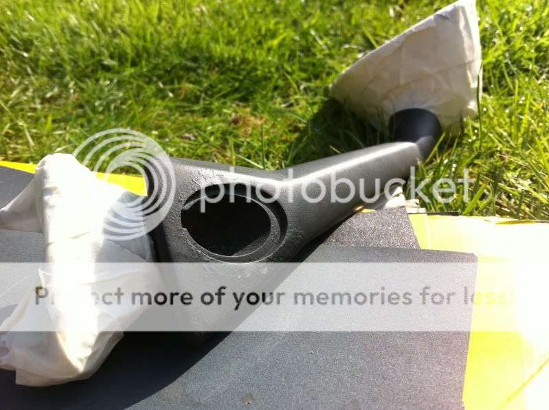

One of the jobs was to sort the wing mirrors, so here are a few pics of the job. Only thing I would change next time is the colour. I went for the Satin paint but now the job is done, I think I would go for the Matt colour if I had the chance again. Although, they still look fantastic!

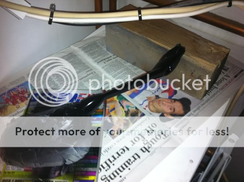

I simply masked up the plastic mirror surround and the bolt ends. Rubbed down using 240, 500, 1200 wet and dry paper. Then sprayed a grey primer (one coat), then applied three coats of satin black paint from a can over two days to allow each coat to dry (stored on top of the boiler after each coat of paint).
The pics are spread over the two wing mirrors.
Hope this may help someone one day....! Thanks again NJFZ1

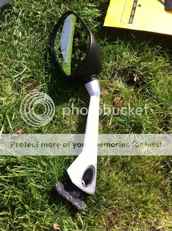

Before:
Paint Removed:
Paint Drying:

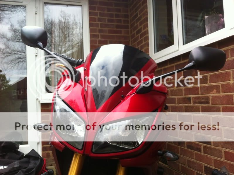

On The Bike #1:

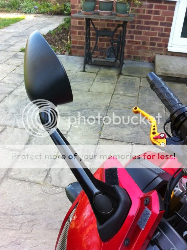

On The Bike #2:
What about a clear coat?
Do you mean a lacquer?
I didn't want to lacquer it otherwise it would give it a very shiny look. I wanted the look to be the same as the frame and the rubber grommet at the bottom of the mirror and also to match the plastic insert.
It came out shinier than I though so a lacquer probably would affect it too much TBH but still, I like them how they are so no need for a lacquer IMO.
