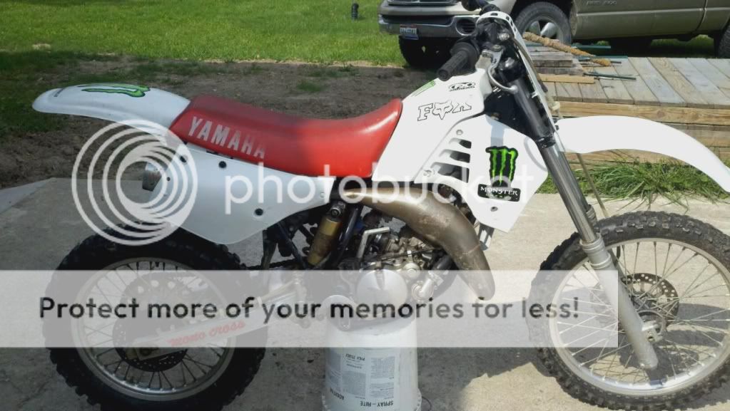

Picked this up today. needs a front tire and clutch cable, should make a fun toy.
Thanks guys I just could not walk away from it when he said $300. we have plenty of space to ride around here.Now I can get out in the dirt with my nephews. When the track opens we will see what it does in the1/4.

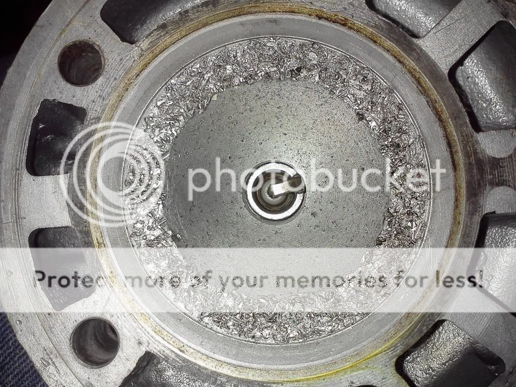

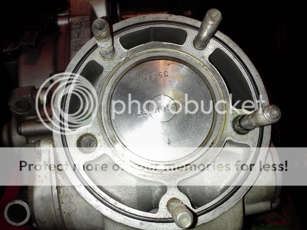

We pulled the head today and the guy was truthful. It has a brand new weisco piston and new berings every where. The piston is 1mm over size(.040). That makes the motor a 128cc. Still have to check the clutch and power valve so Im not out of the woods yet.
so here is why it got rebuilt. The head is shot $40 on ebay.

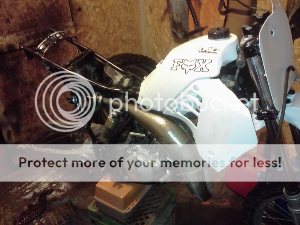

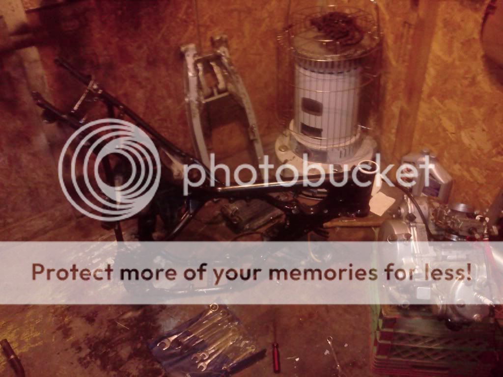

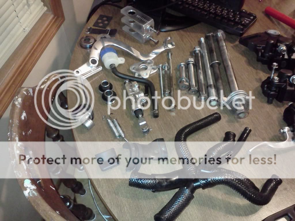

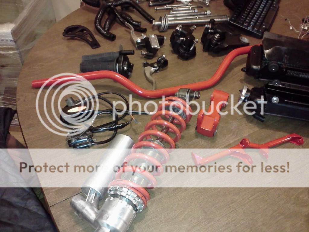

mid build report

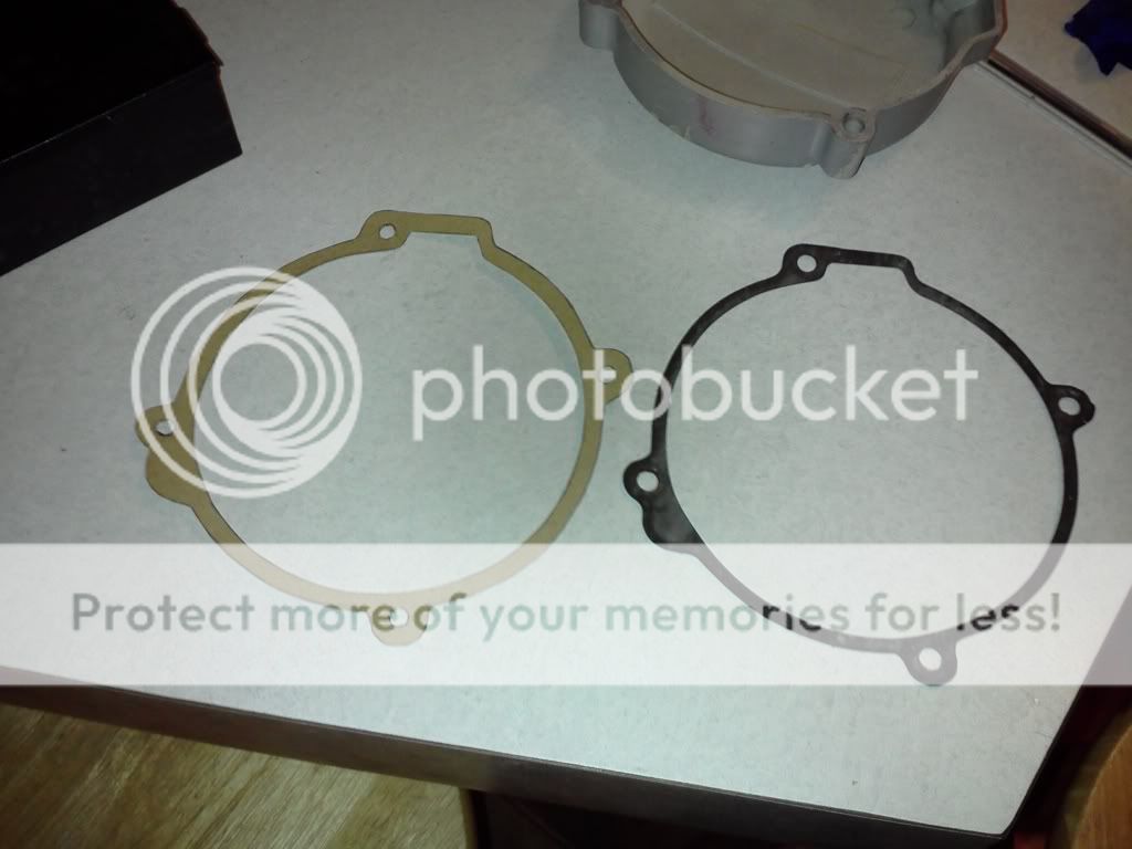

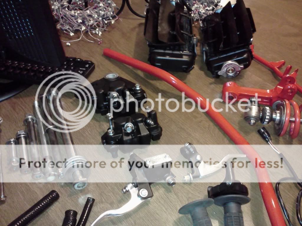

Most of the parts are cleaned up, sand blasted and painted, and some polished. I only have the white. parts to paint(frame, swingarm, triple trees, and fork bottoms). All parts are sand blasted just waiting on me. Have to give a big thanks to dad who did all the sand blasting during his brake time at work and also supplied me new ss bolts to replace every thing every thing on the bike except the odd stuff. My buddy Paul stoped over today with new ss alen head bolts to replace the entire motor and a roll of gasket,thanks man. This is my first try at cutting out a gasket. It turned out nice. with the stuff I had and the help the the runing total is $311
