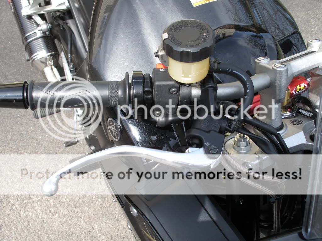

I installed an 06 R1 m/c on my gen1. Bleeding the brakes is easier, since it has a bleed port at the top of the system. I like the feel that I get now and it didn't cost much. The hardest part was fabricating the reservoir bracket. I think that it looks more racy too. What do you think?

Designing a reservoir mount isn't difficult, it was just the hardest part of the upgrade. The most common is to bolt the bracket to the master cylinder rear clamp. Some screw the bracket to the bar, while others use a simple clamp around the handle bar. I got the idea to twist mine while riding the twisted sisters route in south Texas. :th_smiley_rotfl2[1]

I have seen some people use the plastic clamp from a bicycle reflector to mount the mc around the handle bar. It's the type of clamp that holds the reflector to the seat post on the bicycle. It looks pretty good and is a very cheap alternative.

I use a cateye bicycle reflector mount used for a seat post. They are black and blend in perfectly.
