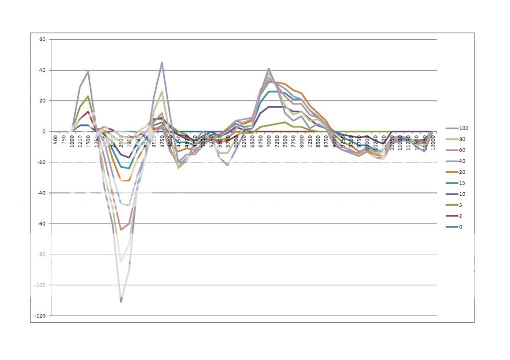

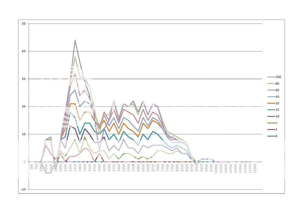

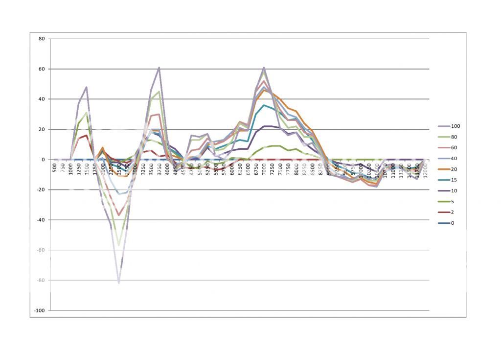

The new map had 2-4 % more fuel across the range. I have plotted the maps and the differences in excel spreadsheet and created pdf's, and will post up once i convert to an image file.
Here are the spreadsheet files showing the map profiles.
The changes on paper look very minor, however it is suprising how this difference is felt on the road. The standard airbox used a bit more fuel in the map and i will have to wait untill i do a decent ride to determine change to fuel consumption, but it certainly feels 'meatier' with the bike pulling smoother from down low and through the rev range. In 6th gear it will take you from 100km/h (60 miles) to 145km/h (90 miles) in about 2 sec (i.e. counting...one,one thousand...two,one thousand). The induction noise certainly sounds cleaner too, having a nice uniform growl. I found the cut box produced varrying pitches of induction noise and sounded messy (if that makes sense?)

New Map: Note, the y axis is scale to the power of 10 for clarity e.g. the 40 value should be read as 4%
Old Map:
Difference log - Amount of additional fuel added to new map: averaging about2%
