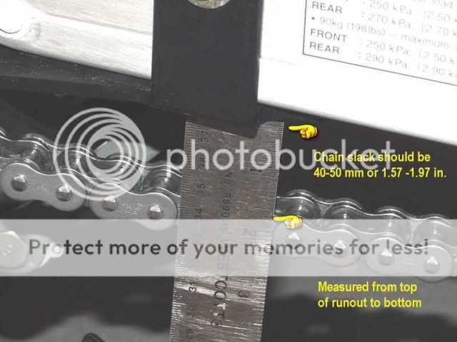

I just checked my owner's manual and the chain slack for the GenI is 1.57" to 1.97" I know it may sound like alot but thats always been good for me. I usually go in between the two measurements and always had excellent chain wear.

Adjusted per pats site
From pats site

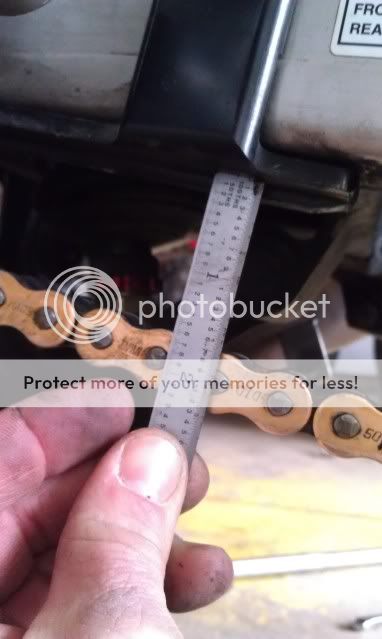

Mine
1.6 is a pretty good medium. I will tell you that the FZI GenI's do have a lot of slack in the chain. I've ridden mine with more than 1.6" of slack with no issues. I usually go in between the two limits and is fine there.

I measure from the top of the chain link to the bottom of my swing arm, by moving my chain up and down, and I set the tension with the adjuster bolts until there is aprox 1 1/4"- 1 1/2" clearence between the bottom of the swing arm and the top of the chain link.
The chain will settle and tighten up once the bike is off the stand though, so check it again once its on the ground. You want to have about 1"- 1 1/4" between the top of the chain link and the bottom of the swing arm. If you have tight spots, or kinked links in the chain, and your having chain tension issues, it might be time for a new chain.
brand new chain. I have only put about 850 miles on the fz since I have owned it, and in that time, its had both a new chain and a new engine, so with that being said I really am just getting a feel for this bike. I have it set as I showed in the pics, and it got rid of the noise that was bothering me. Its still noisier than my triumph was but, I think its the nature of the beast. I hear lots more mechanical noises without all the body work to mask things.
