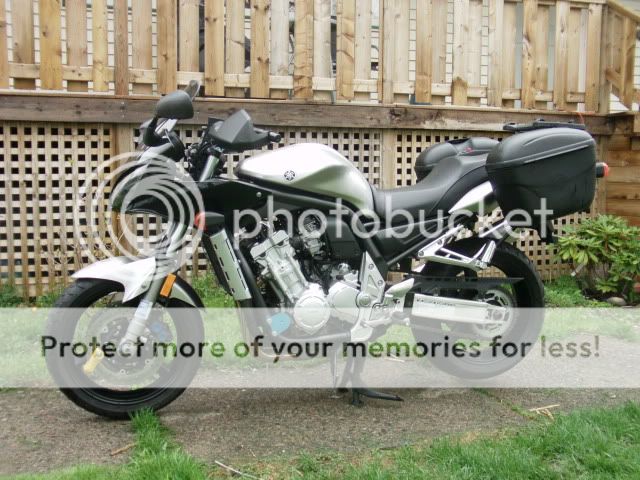

Thought I'd post on how to swap out the front end of a bike. I know it's already been done quite recently on here, But I may run into something different... Also gona post up some paint pics among other things.

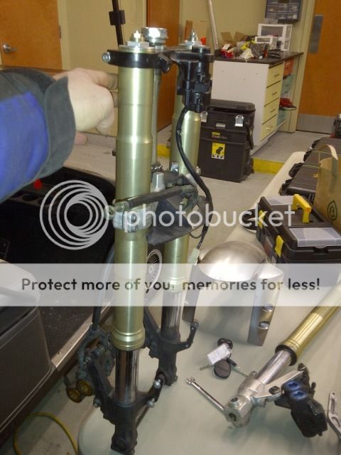

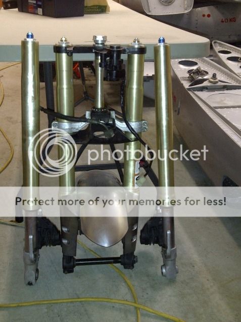

Here are the replacement parts. The loose forks are from a 99, they are a few mm's longer than the other 2002 parts.
I picked all this up for $300 here in Virginia while I'm working here, which is a steal compared to back home in Canada...

Either way, good deal, Now have to decide which forks I want to use, and get to work rebuilding them.

What upper triple clamp?
Hello, I am new to this Forum. I have a 2002 FZ1 and want to up grade forks to R1. I was wondering if you are going to use a GenII upper clamp instead of the R1 upper clamp to accommodate the risers and bars?
Gen 2 tree can be used along with lower, but you'll have to use the Gen 1 stem to hold it all together.
Another obstacle to overcome is the shorter leg length. Devilsyam's is the guru to the conversion and maybe even have some pieces available to help you along. If not, at least guide in the right direction.
