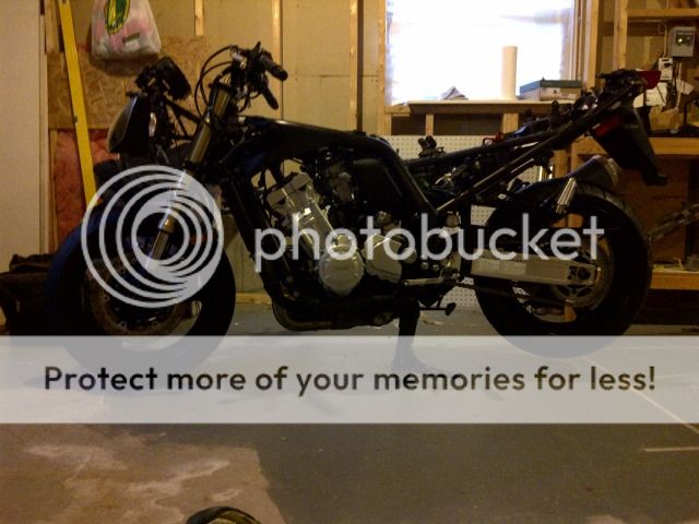

I'll be home this weekend, hopefully once I have said a sufficient hello to my family I can head back out to the bike

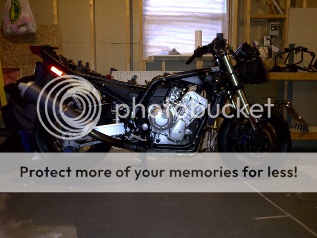

here she is, front end together, new tapered roller steering head bearings, all powdercoated and ready to go. R1 pipe with functional centre stand!
New tires, now waiting on paint.

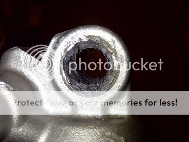

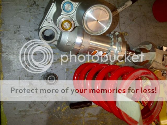

The modified R6 shock I purchased isn't usable in its current state... the rubber in the upper mount is torn up so badly that there is now considerable play in the mount.
I purchased this shock for the spring, and i'm going to see if a machine shop can press out the upper mount and install it in my shock. i'll than have them machine up some stainless bushings so that I can use a smaller diameter bolt instead of reaming out the mount.
Here is the damage to the upper mount of the shock I purchased...

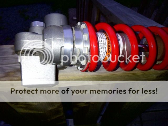

I purchased this cheap r6 shock for the upper mount and pressed it out, drilled it, than pressed it into my shock.
I'm not sure how you damage it that badly, It was actually quite easy with the drill press and machining fluid.

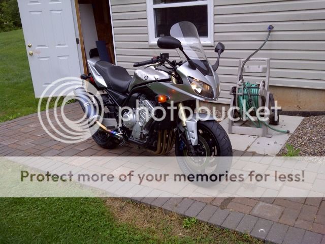

Its finally ready to install

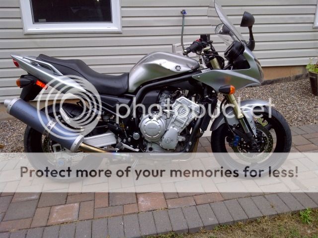

Took the bike for a spin, Man does it feel different! Extremely stable, On the throttle in a turn and it just feels planted. I done even have the suspension tuned yet. Rear isn't soft and mushy anymore.
Quite a bit lower in the front, even with the 2ed gen risers it may be a bit too low for my likings. I'll ride it for a while, maybe I'll ride it for a while and see if It grows on me.
Pictures still have the old ugly tank on there, I was waiting on decals and couldn't wait to pull it out!
That looks really good! Yes there are other ways to upgrade the FZ1 suspension, but none that looks as good as this.
Riding it without extensions does take some adjusting. When I added mine after riding it a couple of months without them, I felt like I was learning to ride the bike all over again. Then after I got them powder coated and cut down so I could adjust them, I'm learning all over again. With the r1 forks and the r6 shock, my bike feels like it's on rails!
