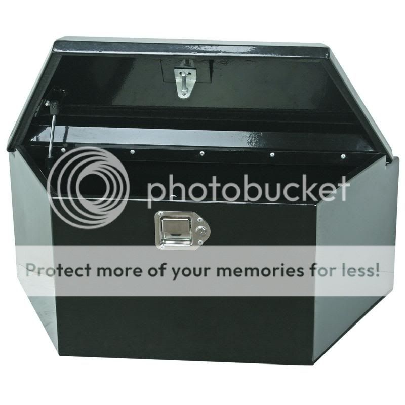

That should work out nice. You know that H.F. has the metal Gear Box for the front of the trailer on sale now. It locks and can store a lot of stuff. Just letting you know. The best part is it doesn't take up any square footage of the actual trailer. It bolts to the triangular section up front.
