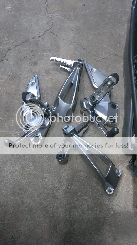

It must be getting close to riding season as I'm here starting a new thread. Actually it's just a question about powder coating my rearsets. For as long as I've had the bike, it has bugged me that the bike is literally all blacked out except for the rear footrest brackets and the rearset brackets and heel guard which are silver. I removed all of them this morning and the powder coater is ready for me with some satin black powder.
My question for anyone who has done this before is: my concern is on the rearsets, they have a pressed in bushing where they mount to the frame of the bike. Will that get ruined in the powdercoating process? Do they need to be removed first? Any help would be appreciated. Otherwise I'll just do the rear passenger footpeg brackets and call it a day. Thanks very much.

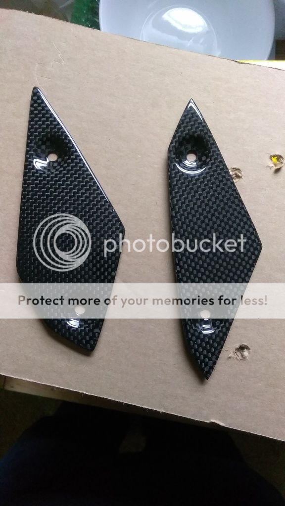

I thought the same thing about all the silver...your gonna like it...if you decide to try the carbon fiber heel plates i think i have a couple pair somewhere...i had the powdercoater leave the heel plate area silver and did the area right below that in black.

You are right. I think I'm going to leave out the heel plates and pick up a pair of CF Plates. I think it will give some contrast to the satin black. Thanks for all the help!

I'll let you know how it works out. The coater said he'll let me know once he looks at them. If he doesn't feel safe doing the front set with the pressed in bushings, I'll do the rear brackets, foot pegs, and just spray the front brackets. I have the carbon fiber heel plates coming this week so that will kill most of the silver. All the hardware (bolt heads) are going to be sprayed as well. It should look good. I'll post pics once I get them back.
Ok... here is just how observant I am of my own bike.... I must have been thinking of the 2009 or her Beemer... The '13 comes with black rearsets! DOH! As for those bushings, pop them out with a vise/socket pressing. Spray paint won't last and you'll be doing it all over down the road, this time having to clean paint off to get them coated properly. You won't regret it Billy!

Ah, I see. The stock tail probably extends the rear tail lights back farther, making clearance for the rack. I'll see about pressing out those bushings. The coater said they may be able to stay in with no issues. I'll let you know.
