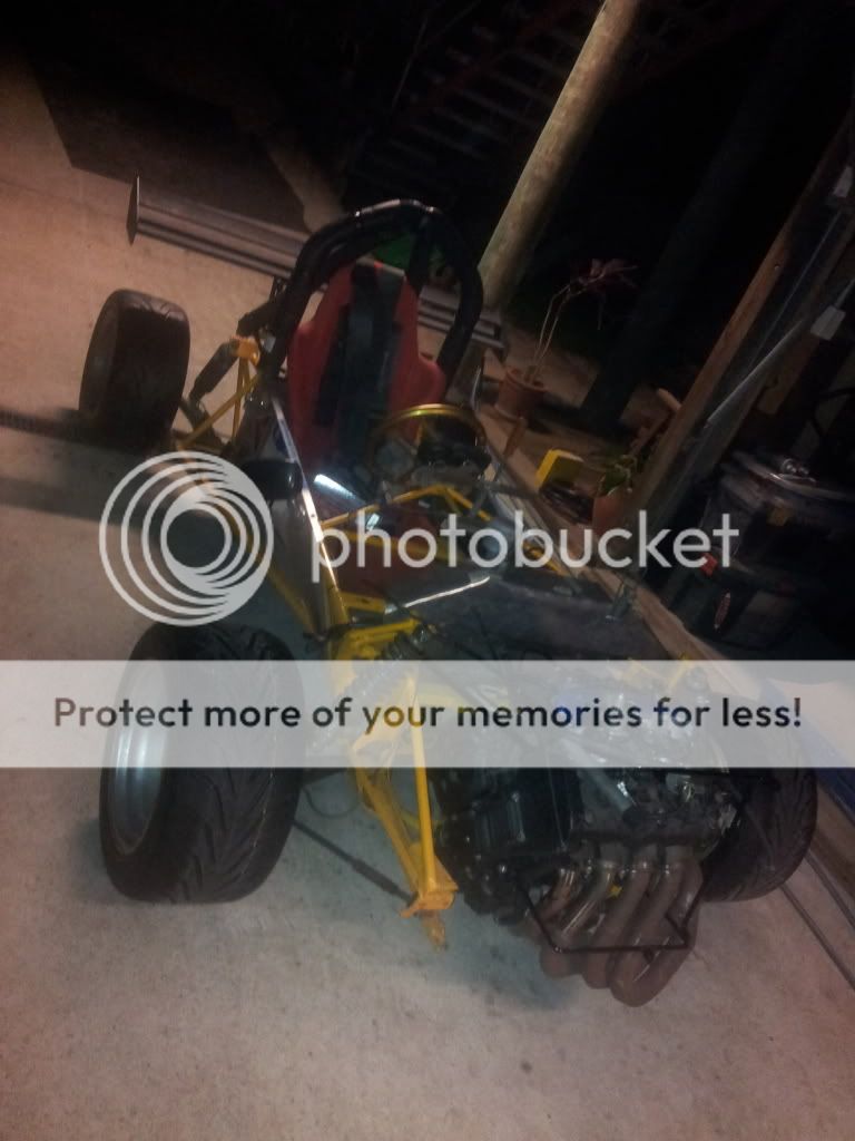

Hi all,,, sorry if this is the wrong spot, i`m new here & have trouble working out how to wire up the engine to suit the buggy
i think we have an imobiliser problem but now that 3 different fellas have had a go at wiring things up it`s a bit of a big unknown now as to exatly what`s goin on
so my question to you all is--> has anyone know a decent place or person who can wire this buggy up for me to make it go Vrooom?
it`s an 07 FZ1 & fitted into a hillclimb/motorkhana/autocross special
here`s a few pics-->
we used to have an old 98 R1 engine with carbys runner her but i ran it a bit low on oil & it went "lack-a-lacka" yuk!
so i grabbed this 07 FZ1 donk & just need someone in Brisbane who knows what they`re doing to wire it all up,,, i now have 2x complete matching & coded looms , computers, keys & imobilizers... & i also have a new power comander for it ready to go... just that it won`t go
