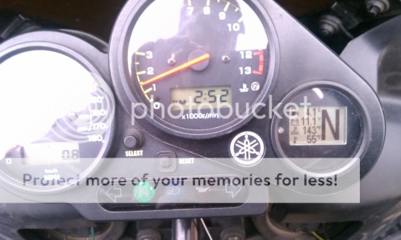

I think it's one of the most desirable upgrades for the FZ1. I primarily wanted this for the gear indicator. Why this is not standard equipment - I will never understand. There are several options on the market but I just didn't like those little add on units that you have to stick to the speedo. I know a lot of folks run those and that's fine, it's just not what I wanted. So if you are looking for an upgrade during the cold weather - I would recommend the Multi Gauge. Price is around $200. Here is what's involved.

Before and after:
Before:
After :
It's worth every penny. Quality construction and the designer is a real nice guy. I highly recommend this upgrade. In fact, I would recommend jumping on this because Christian (the inventor) stopped making them for a few years. THEY ARE IMPOSSIBLE TO FIND USED. Quite simply - no one sells them. Well - I did see one or two in the classifieds but they were snatched up in a few minutes. Good luck with that approach.....I tried for 2 years.

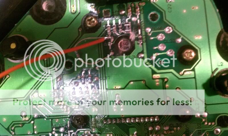

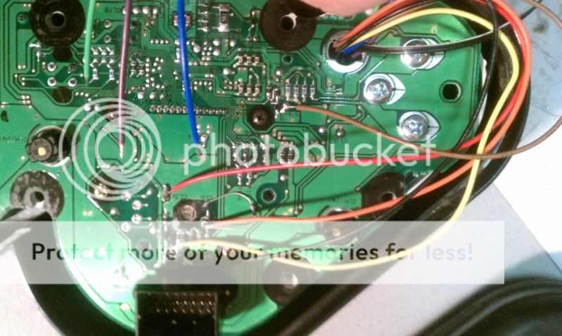

Here are some pics of my assembly:

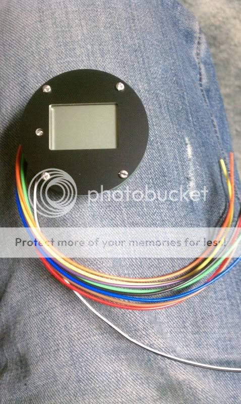

The way the gauge arrives:

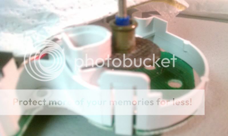

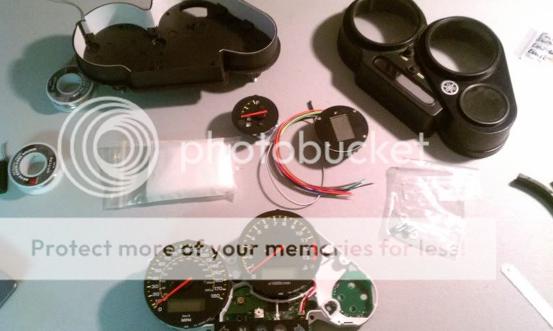

Speedo disassembled:
One pointer. I love my Dremel and use it often so when I saw in the directions to use a hacksaw blade I thought these were just some old guys who used hacksaw blades. LOL Well I should have known that there was a reason. The Dremel will not cut all the way through during this step. So if you are a Dremel user like me - I recommend using your Dremel to cut through to the this point - then use the hacksaw blade to finish it off. I also used my Dremel to smooth out the cut and make sure it was level. Note: This is not a super important step but I just thought I would mention it.

Before and after:
Before:
After :
