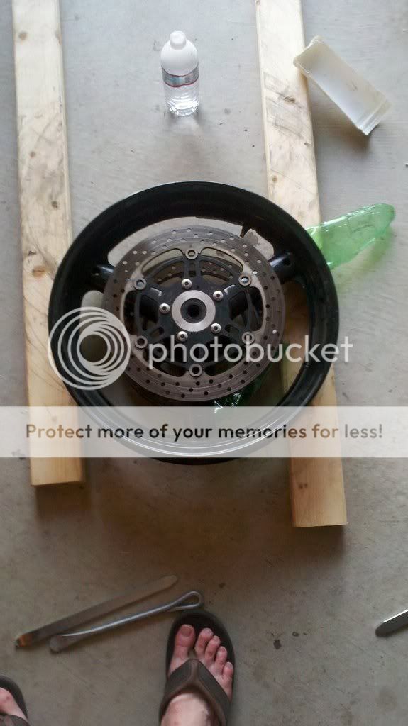

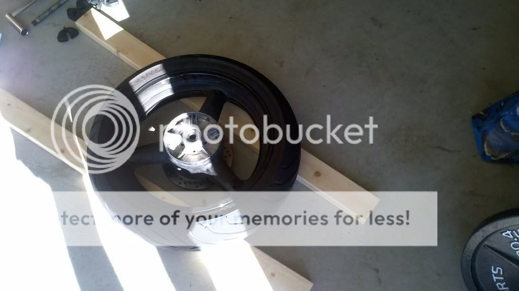

Got my tire supported by 2 pieces of wood so I don't damage the rotor. I am going to change it to a triangle so it supports it easier.
I removed the valve core to release the air.

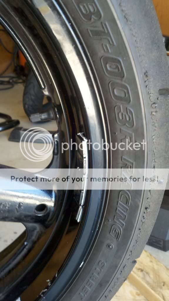

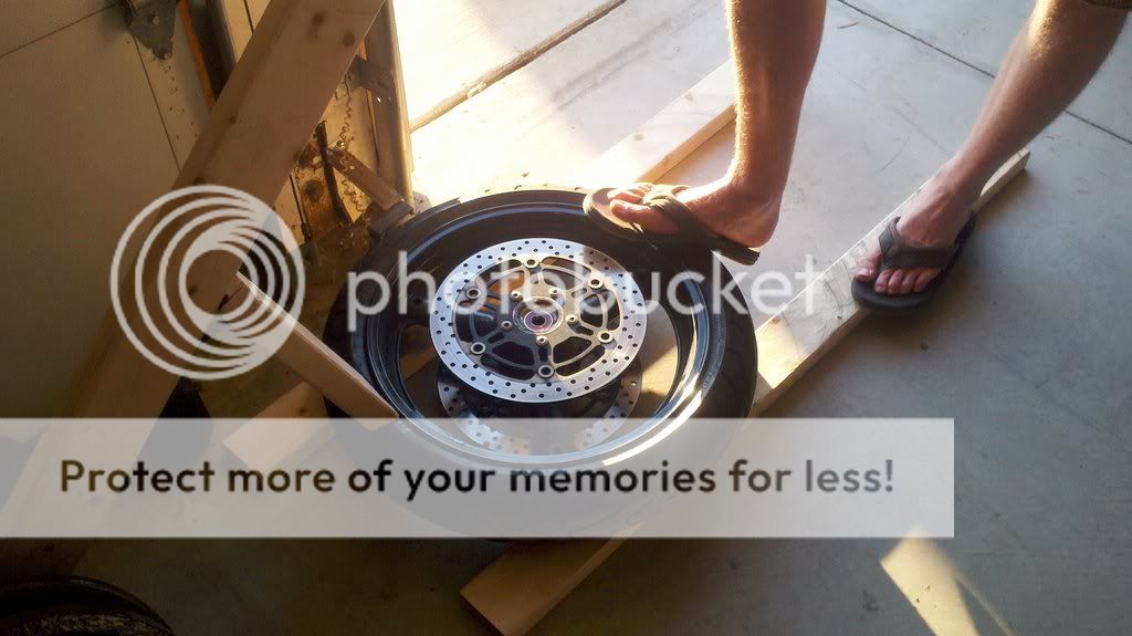

Found online an easy way to break the bead with wood. Worked great.

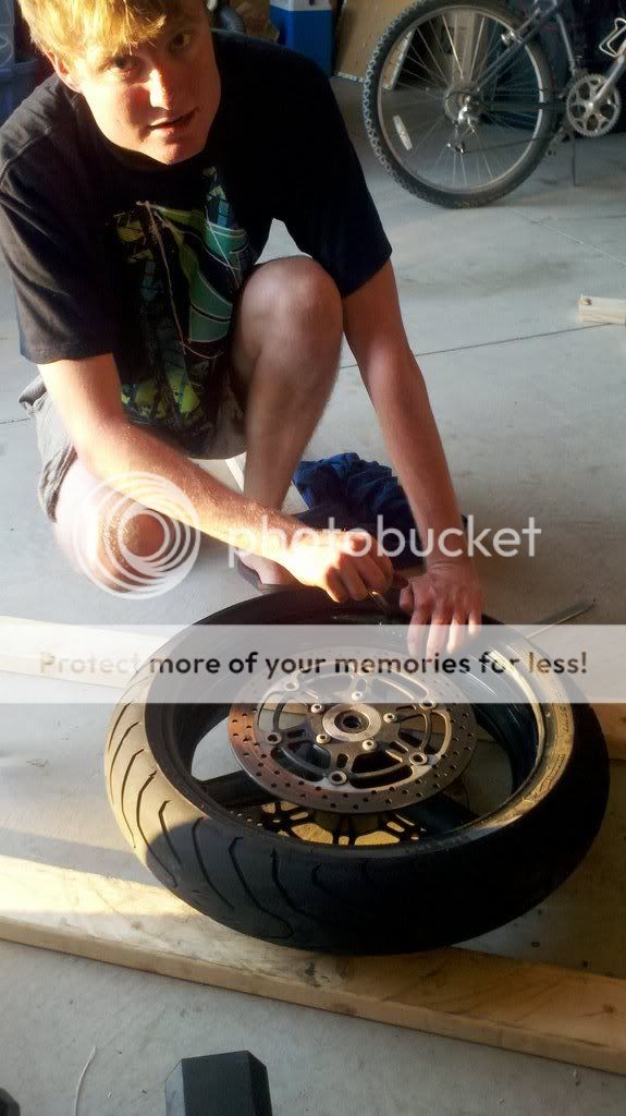

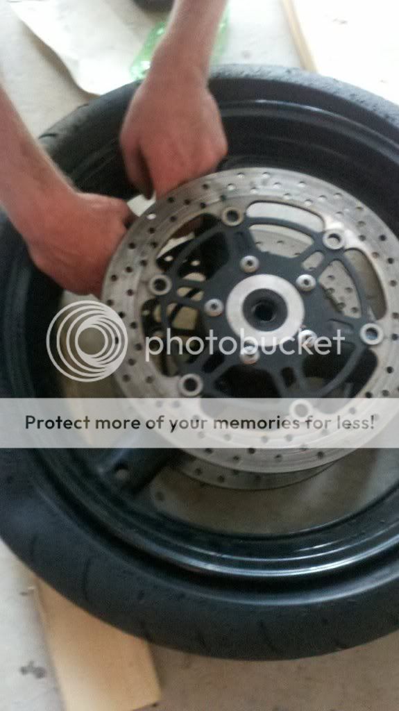

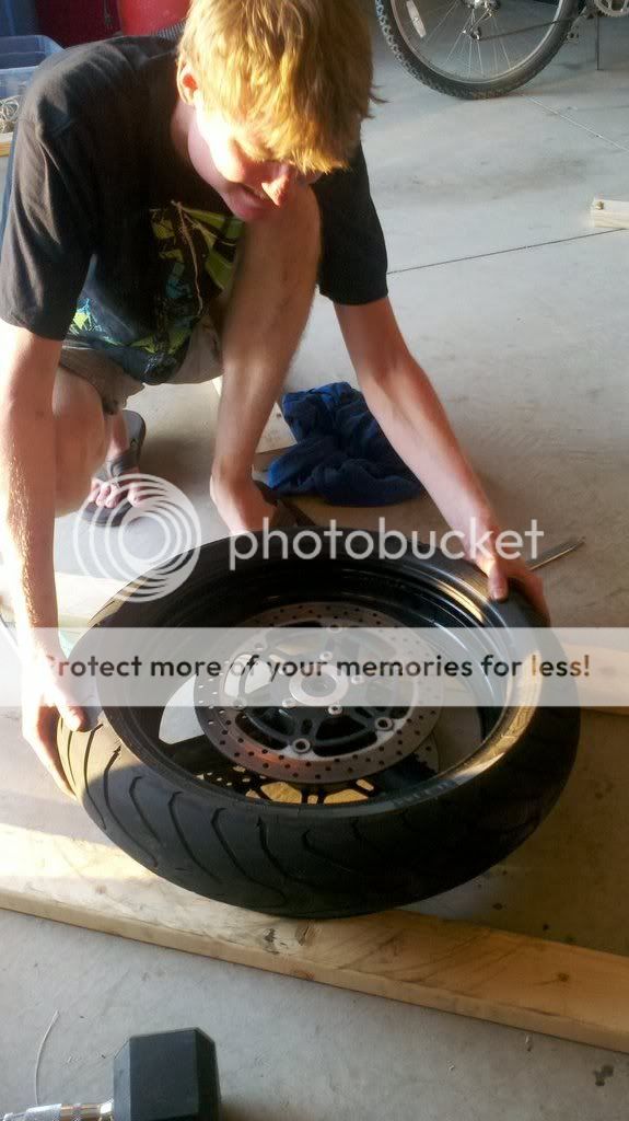

Then I used tire irons to take the wheel off the rim
The first one was difficult, but the 2nd tire was much easier now that I knew what to do.
Putting the tire back on, pretty much the opposite to pull off. Just make sure the tire is facing the right way and the mark is on the valve stem.

I do need to figure out better rim protectors. My plastic soda bottles sucked. Maybe cutting a hose in half would work better.

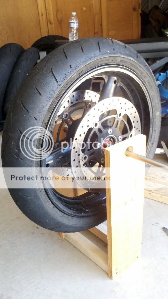

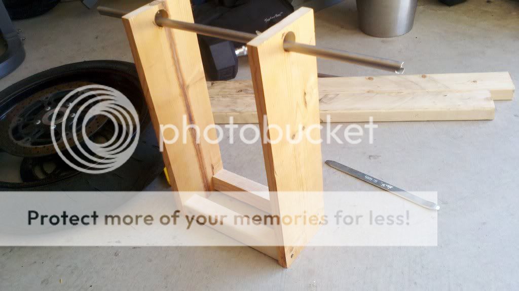

So after looking around my garage I decided to make a balance stand instead of spending 50 bucks for a Harbor Freight one.
Now I have 2 balanced tires.
It's easy to make stuff out of wood when you have all the cutting tools.

Hi Mud,A lot of good ideas,but I am not sure about your balancer you need to use cones to centre the wheels properly,also I would run the rod through the wheel on bearings so the wheel turns freely.a set of longer tyre levers would make the job easier,I like the wood bead breaker a good simple idea

My balancer works fine. I have tested some of my race tires that got mounted at a shop and it showed that it was balanced on my contraption.
